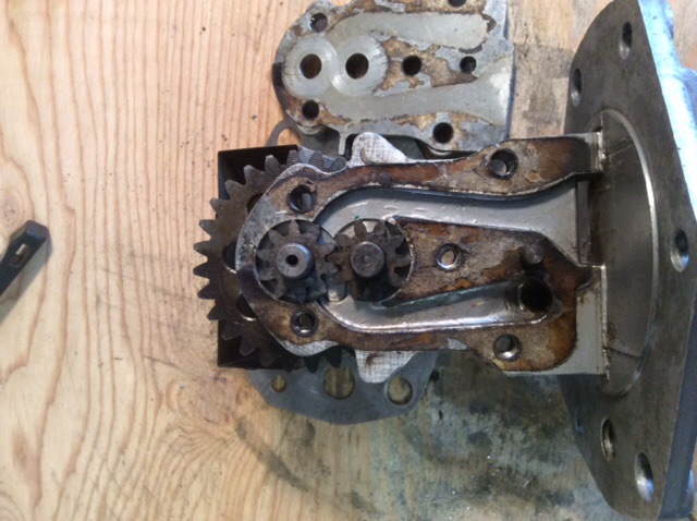

I opened the pump up. Unfortunately, I had to drill the head off of one screw. Inside looks ok to me, but I'm eager for expert opinions.

Yes - the gears are nominally the same diametral pitch (14 DP) but are actually larger diameter and the shaft centres need spacing out. I made a sizing jig so that I could measure the correct running clearance. The non-driven gear is moved down and is larger diameter shaft. The hole for this shaft overlaps the original hole in the casing so there are no holes to fill up in teh case.
