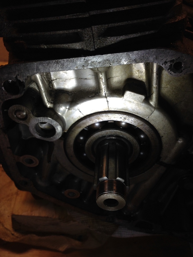

Finally got my clutch cover off and started diss-assembly there. Question. Above the centrifugal oil seperator I see what looks like spider webbing. Can't tell if they are cracks. What do you guys think
clutch side.jpg (84.1 KiB) Viewed 2681 times

Post by Hahnda » Sat Dec 13, 2014 8:10 pm
Those are actually just imperfections in the casting. Nothing to worry about.
Post by LOUD MOUSE » Sun Dec 14, 2014 2:09 am
I agree. ..........lm
Hahnda wrote:Those are actually just imperfections in the casting. Nothing to worry about.
