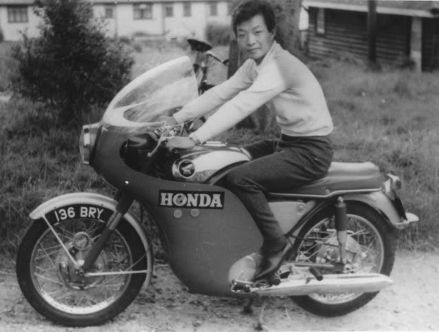

Just found this wonderful picture of one of the first CB72s to arrive in England. It was taken at the TT in 1962 and the guy sitting on the bike is Kunimitsu Takahashi who was leading the 125 world championship at the time.
http://forums.autosport.com/topic/91269 ... ia/page-71
This bike came into England in May 1961. It looks like a blue bike with a blue seat to me.....

Hey G. thanks for posting the picture, of that bike and rider, the Takahashi family still racing bikes in Japan!! Vince, on the gas tank question, I know people that leave a gap then coat it with fiberglass resin.

2 more I just noticed, it has small front brakes, and a colored seat.

Interesting to look at the clutch lever. There is some discussion that they would have been like early Dream or CB92 with tiny ball-ends.
The front brake is the same diameter, but single-leading-shoe.
The owner has also removed the seat strap and the rear light bracket is silver.
You can also see the hollow wheel spindles - the rear is drilled right through - and the black rear brake cable. Front brake cable is gray and the speedo and tacho cables would be black.
You can see that it is not a regular British import as there would have been holes and brackets on the front fender for the license plate.
