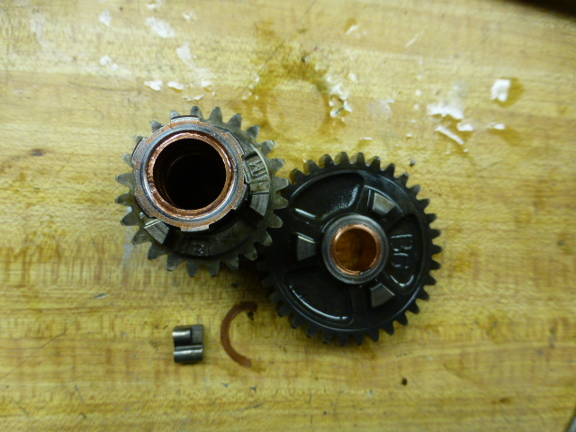

Got it torn apart. 14mm bushing came part and seized in the gears, detailed in my "bronze in filter" thread. Also causing my kick-start problem because 1st gear was so loose on the shaft.

Post by LOUD MOUSE » Tue Aug 22, 2017 6:18 pm
Is the part of the bushing that is still in 1st gear the end with the taper in the hole or the flat end?. ..............lm

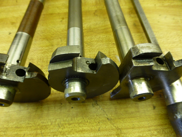

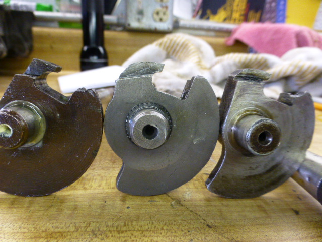

I have 3 choices of kick-start shaft. I noticed that the spring holes are in different positions on each of them, but I don't think that is an issue.
Middle shaft is one that was in it, I had to modify the bushing slightly to accommodate the splined area on the end, which the other two shafts don't have.
What I am wondering about is the tip to the right of the slot. I'm guessing that is where the shaft hits the stop bolt in the resting position. Is the wear excessive where it would be a problem on either the one on the left or the one on the right? If so, has anyone tried building that area up with weld to save the shaft?
