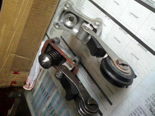

Tension caused by tensioner
I couldn't find a tensioner for a CA77. I bought one for a superhawk instead. I remove the roller from it and use that on my old tensioner.
Hope it works.
