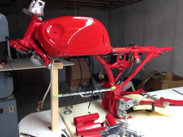

Finally, after 2 years I am back on this project! I have had the frame powdercoated Bloody Mary Red and painted the fuel tank and other red parts to match. Chrome is sent out for plating. I have most of the parts assembled on the frame, wiring, steering neck etc.

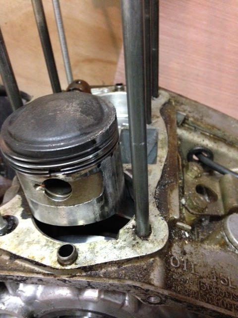

I decided to pull the top end apart and glad I did. The left piston is very tight on the wrist pin and the rings are stuck. The rods have no up or down play but they can have a slight play when wiggled sideways. Is this normal or am I in for a crank rebuild?
'66 CB77 '75 Rd125
Post by LOUD MOUSE » Sat Nov 30, 2013 7:51 pm
slight play is OK. .....lm

I LIKE that red! She's going to be a pretty bike!
