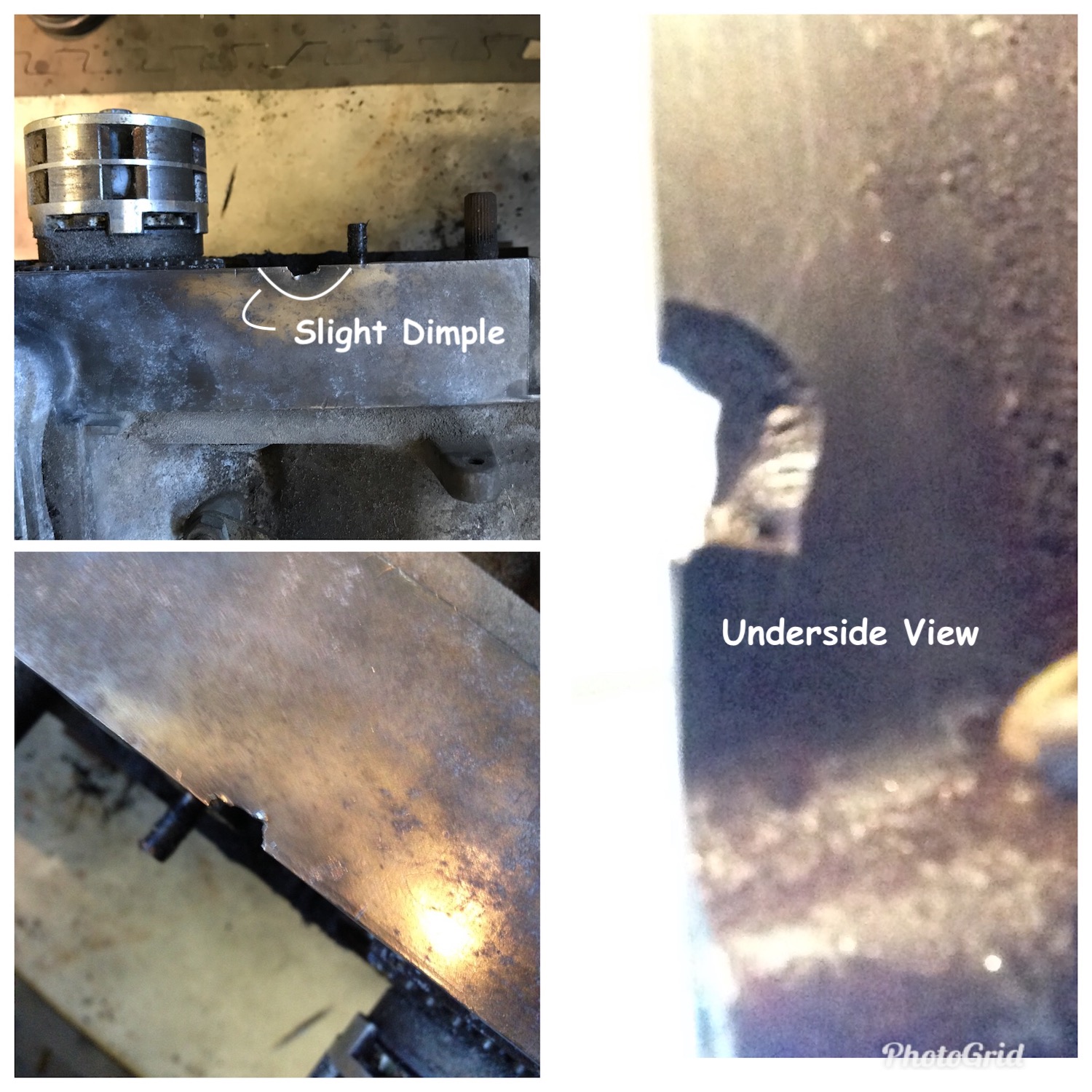

I've accomplished very little today, but I did find something that I missed when I first looked at the bike. I found a small chunk taken out of the upper crankcase on the right side. I just don't know how that got by me, but I would have bought the bike anyway, since it was a good deal. I just would have bargained the price down a bit more.
See the pics, below. The missing piece isn't big on the top side, but there's a chip missing on the inside. The top is also dimpled down a little bit. It looks as if someone pried the right crankcase cover off. They probably hadn't taken the stator cover off. Just guessing.
I think I'll try Aluma Weld or some other aluminum brazing brand to fill that, then file it down flush. If it doesn't work, I suppose I can find another upper case fairly cheaply. My original intention was to use a different titled frame with this engine, but I had begun to think that, since this frame is just so good, I'd try to title it and sell the other titled orphan frame. That way, I could keep the bike original and the engine and frame numbers would mean something. The numbers are 42 digits off. If I can't make a repair and have to use an unmatched top cc, I'll drop that idea and just go back the "mutt" bike option. At least I have options and I get to try something to make a repair that I'd never tried before.

Hi Seadog
A good candidate for aluminum brazing but you will have to cope with teh different color of the filler rod from the crankcase material.
To preserve the original number I would go ahead with the repair, sand it smooth, then paint just the top crankcase with high-temperature engine paint.
That will disguise the repair and give a nice finish to the case.
Just my two cents......

Post by Geoff Hastings » Tue Jan 30, 2018 1:25 pm
