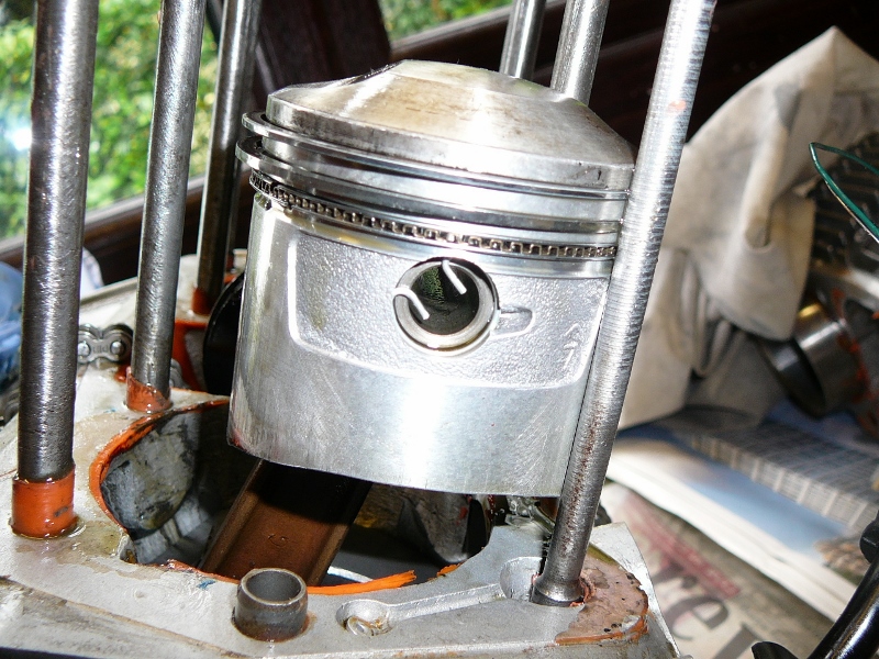

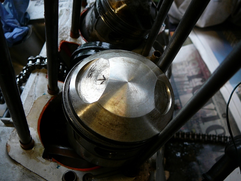

Can anyone identify the pistons. I measure the bore as 63.75mm.

AlanW
Posts: 167
Joined: Tue Jul 01, 2014 6:33 am
Location: Wirral UK.
Post by AlanW » Tue Oct 03, 2017 4:42 pm
Hi Greg,
I am in the process of building a cb77 and the head gasket in the kit I bought off ebay for £35 measures 63mm.
Al.
GregMcN
Posts: 236
Joined: Tue Jul 04, 2017 3:34 pm
Location: Richmond, North Yorkshire, UK
Post by GregMcN » Tue Oct 03, 2017 5:02 pm
Thanks Alan
I also have a standard gasket and as you say it is about 63mm which is for a 60mm bore. So the implication is for a standard type gasket you need it about 3mm bigger than the bore but I assume this allows for the metal bit squashing down. For copper gaskets I have been told you only need to allow about 0.03" which is about 0.75mm but I do not know if this is correct?

GregMcN
Posts: 236
Post by GregMcN » Wed Oct 04, 2017 7:52 am
Al
Thanks as you say as clear as mud, let's hope someone else on the forum can provide some guidance.
On another note do your hepolite pistons look like the ones in my photos ... I assume not as I am measuring mine as a bit smaller but have not identified them yet.
