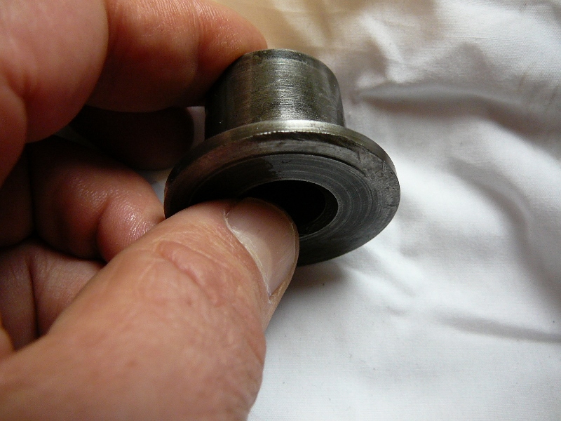

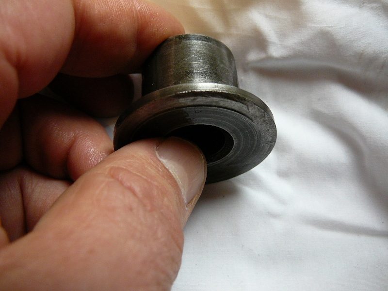

All
I tend to agree that someone has tidied up the gear dogs with an angle grinder but do not think welded though I will have another look with that in mind.
I did not notice much wear associated with the rollers/kick start shaft but will have another look. The obvious wear is on the bushing at the other end adjacent to the kick start pawl.
Greg
Greg
- Wear /damage on bushing
- P1060665 (800x600).jpg (52.8 KiB) Viewed 4206 times
Greg
I think it would be good to get replacements for those parts tp give you a good start with your rebuilt engine. I am away for a couple of weeks but will happily look through my spares when I get back if you haven't found anything by then.
