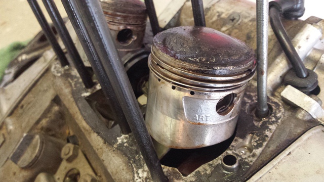

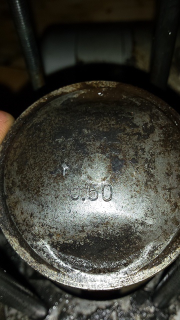

Stupid question here but I looked at the pistons and see that the top is marked with 0.50. The sides are marked ART and CB77.
Does this mean the Pistons are 60.50 mm?
rrietman
Posts: 561
Location: bellingham wa.
Post by rrietman » Wed Jul 26, 2017 4:56 pm
yes

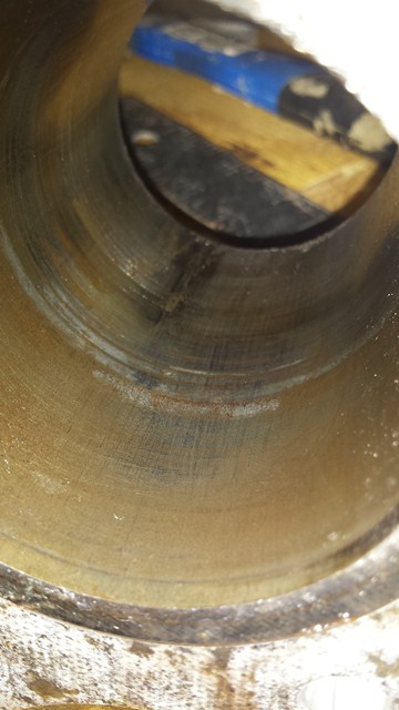

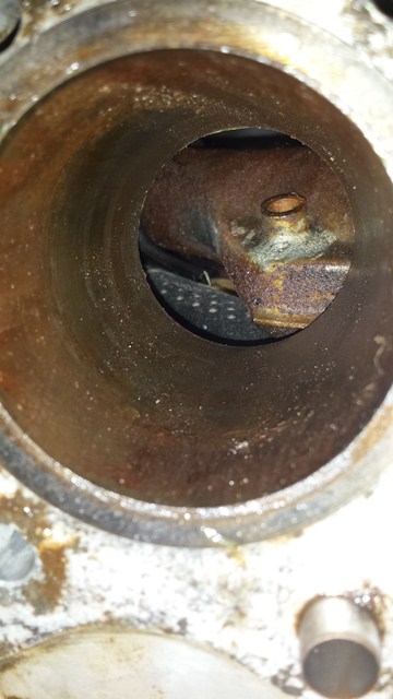

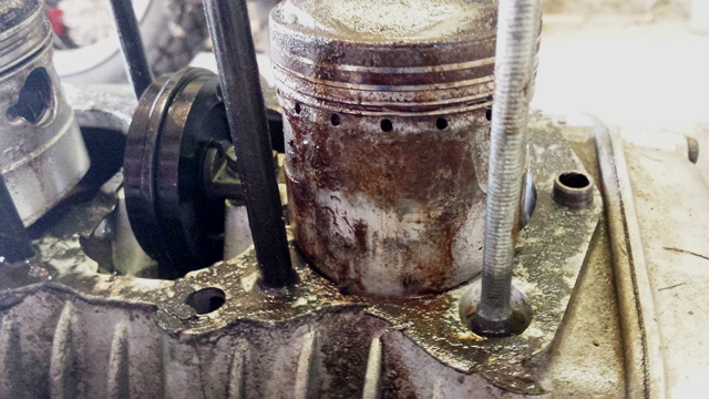

here are some pictures of the 0.50 piston, rings and cylinder bores. One cylinder and piston is worse than the other. would you recommend that I hone the rust off and re-use the existing pistons and just purchase new 0.50 rings or overbore to a 3rd or 4th and buy all new from Tim at Classic honda restoration
Better piston of the two
worse one of the two
worse cylinder bore. note my rusted muffler on the bench
better cylinder bore
existing piston
existing piston
