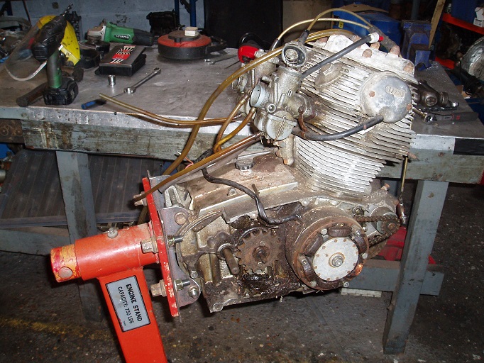

More on the resto in that I decided to start on the engine, so the first thing was to make some plates to mount it onto a mobile stand and so I could then tilt it through 360 degrees. (see pic)

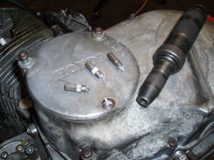

The oil was drained and the filter cleaned - only a small amount of crud - but I had fun getting the oil filter cover off, breaking 3 screwdriver bits with the impact driver. And I was being gentle...! Yes they were not impact bits, but I thought it should work.
Maybe this engine had not been apart for a very long time, or not at all.

Post by Seadog » Wed Dec 14, 2016 4:30 pm
You need JIS bits/screwdrivers.

I like that bracket that you used to attach the motor to the engine stand. I need to rig up one of those.
