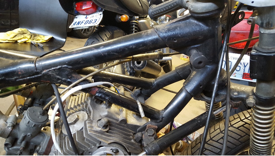

Progress:
(I can't seem to get these pictures to auto size... is there a trick to it on this forum or do I need to upload lower resolution images that I can link here?)
Today I did some cleaning/wiring/mounting of stuff.
Here's where I ended up.
http://i.imgur.com/540EV4c.jpg

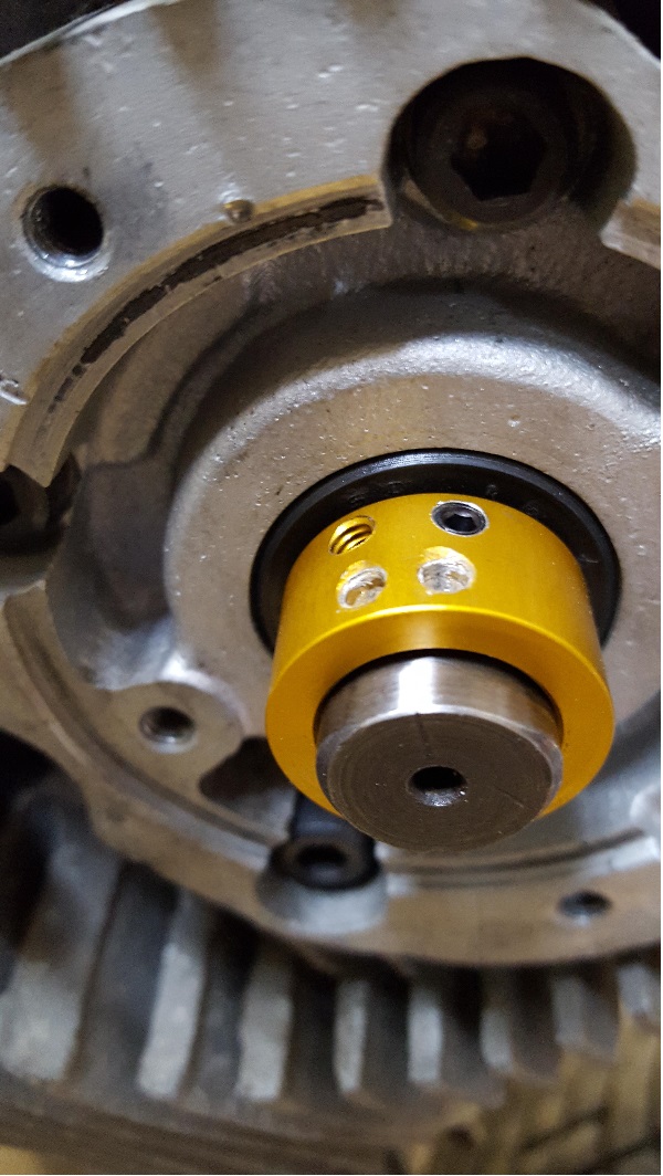

I do have a question regarding the ignition... those two holes closest to the end of the shaft have magnets in them. should I center them on the marker line?
http://i.imgur.com/YgmYLxu.jpg
Degreased the frame, it had a fair amount of film on it:
http://i.imgur.com/lJSOq8J.jpg
http://i.imgur.com/nUoquX5.jpg
Here's a look at the custom/homemade velocity stacks:
http://i.imgur.com/EFAXwVA.jpg
http://i.imgur.com/QKNt9Kd.jpg
In regards to the velocity stacks, I'd like to have some sort of filter over them... or remove them and go with modified air filter elements like this:
anyone have any thoughts on that?
Finally, the starter motor and chain. Thanks to another forum member for sending me a chain, they're awfully hard to find... my one issue now is that there's far too much slack in the chain. I'm thinking of putting a spacer or washers between the case and the starter motor to take up some of the slack. It's not going to take much, so I think it will be feasible for now (until get the motor running again and take the starter off).
http://i.imgur.com/aQsXP2Y.jpg
I mounted the starter solenoid to the battery box.
http://i.imgur.com/gg4XcHc.jpg
My next step is to finish up all the major wiring... I forgot how much of a pain that is, even though everything is color coded it is still mentally exhausting.
I also have a starter clutch rebuild kit coming, the one I have looks like it functions, but I may as well while its out. Those three screws holding the cover on are going to be a challenge to get out though, supposedly they're staked but I can't see any evidence of that.
After that I'll give the carbs a good cleaning, change the oil, clean out the filter and check the primary chain, check the valves and we should be good to try to get it started.

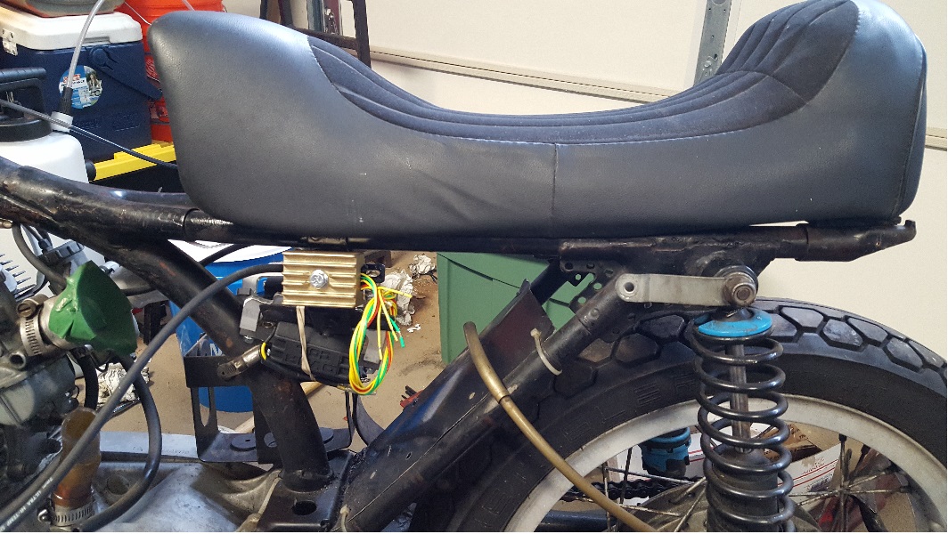

- Test fitting the under seat components
- test fit.jpg (132.42 KiB) Viewed 5947 times

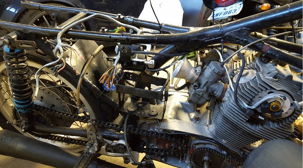

- End of day progress
- overview.jpg (186.99 KiB) Viewed 5947 times

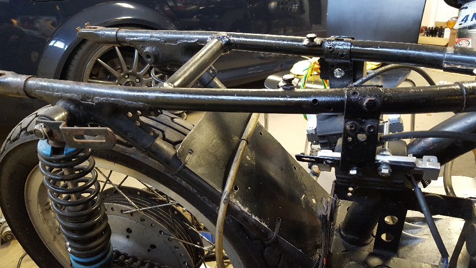

- Frame degrease and cleanup
- frame 2.jpg (123.71 KiB) Viewed 5947 times
- frame1.jpg (156.96 KiB) Viewed 5947 times
- Ignition magnet... proper placement?
- ignition magnet.jpg (89.56 KiB) Viewed 5947 times
