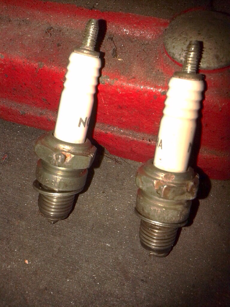

Post by casamere » Mon Nov 07, 2016 6:47 am
This is why you replace things, other owners maintenance efforts.
