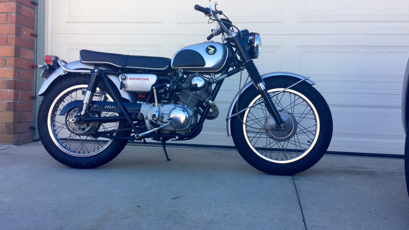

I find interesting the differences in the foot brake position. Mines a '66. Is your pedal arm up against the bottom of the foot peg?
Sorry for the big image, but next size down it gets fuzzy :(
1966 CL77
1966 CL77

@G3, it looks to me like your pedal is clocked wrong on the shaft. The top of the pedal should be level or in line with the foot peg.

jgger wrote:@G3, it looks to me like your pedal is clocked wrong on the shaft. The top of the pedal should be level or in line with the foot peg.
Looks like the foot peg is bent upwards

You know, I never really paid attention to it until I saw Sprokets bike.
Sure enough, I went out and studied the pegs and discovered the tube that supports the flexible peg was bent inwards or upwards really, to almost touching the side case! Both sides too!
That tells me a little history of the bike huh? Kaa-raash...oops.
I was able to leverage them downwards to were they almost look like the Honda Maintenance books picture.
