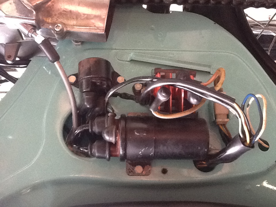

Post by Hondaboy » Tue Jun 28, 2016 6:57 pm
Here is a picture. I am sure this is the original. I have seen others like it.
DianneB
Posts: 287
Location: Manitoba, Canada
Post by DianneB » Tue Jun 28, 2016 8:02 pm
Off the top of my head I think the primary resistance should be between 3 and 5 Ohms. Secondary I am not sure but I think it should be around 10K to 20K Ohms.
Hondaboy
Posts: 17
Joined: Sun Jun 05, 2016 9:13 pm
Post by Hondaboy » Tue Jun 28, 2016 9:19 pm
I did clean the points with a business card and no effect. I maybe leaning toward a carb problem again. May start looking for another carb I am running out of options.
Hondaboy
Posts: 17
Post by Hondaboy » Tue Jun 28, 2016 9:23 pm
Thanks I will check the coil tomorrow.
