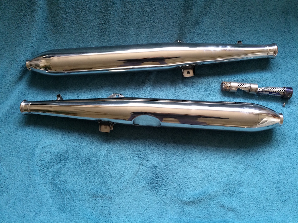

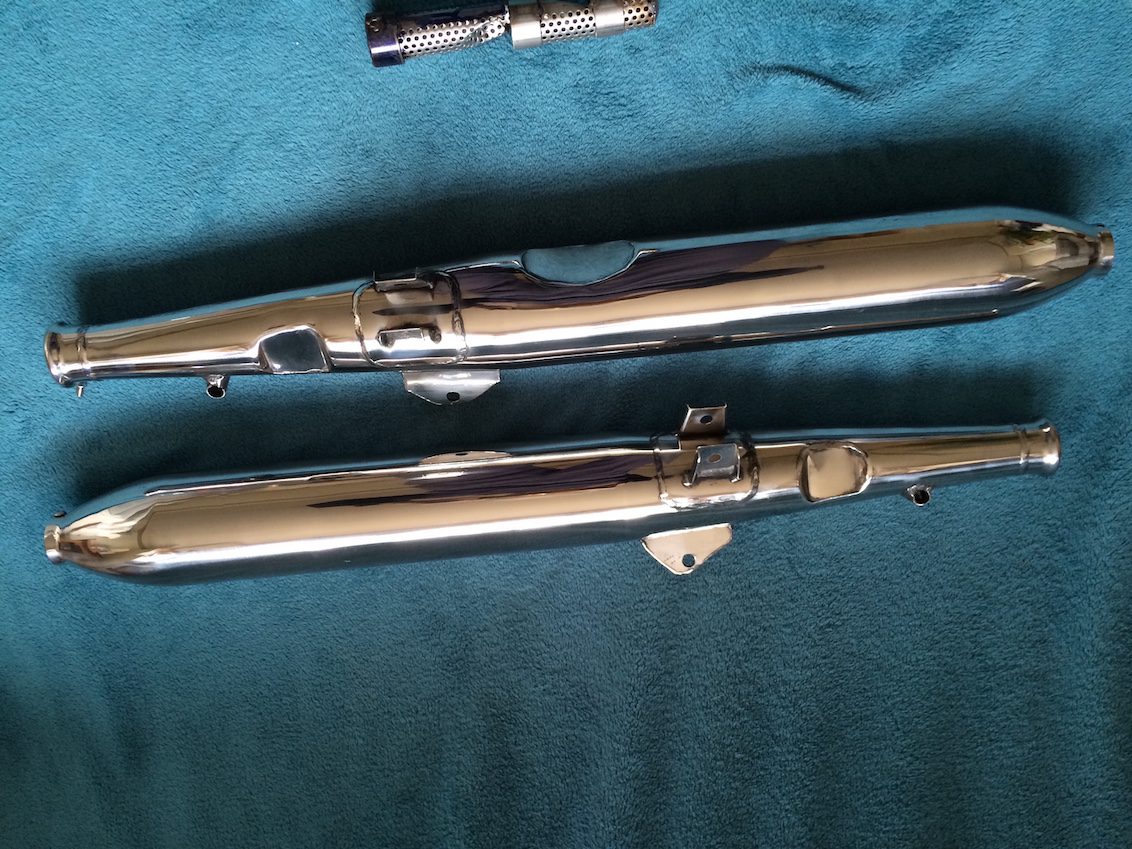

Pics below.
Pics below.

- Muffler2.jpg (197.62 KiB) Viewed 4039 times
- Muffler1.jpg (206.99 KiB) Viewed 4040 times
They look rather nice and should outlast the bike and, perhaps you too!
