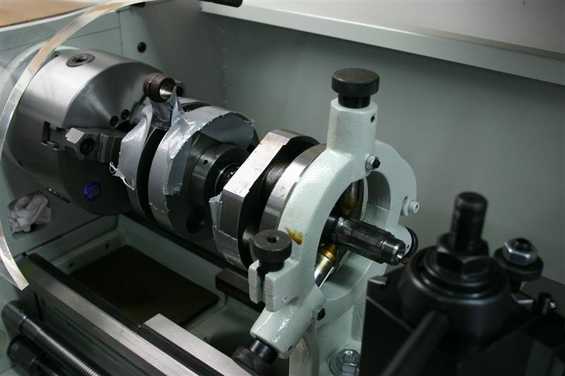

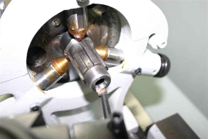

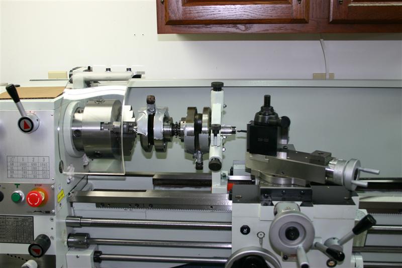

I like your idea of taking a cut across the crank OD - I will do that on all cranks before disassembly - I've always scribed a line on these just for a basic reference.
One of my cranks had a damaged center [30 degree], probably from a bearing puller in the past - I like to keep these intact/undamaged, in case I ever need to put them between centers; I just recut this one - I can then use my live center in the end to cut the OD's.
Sometimes work really gets in the way of important stuff, like motorcycle riding, repair, restoration - the three R's!

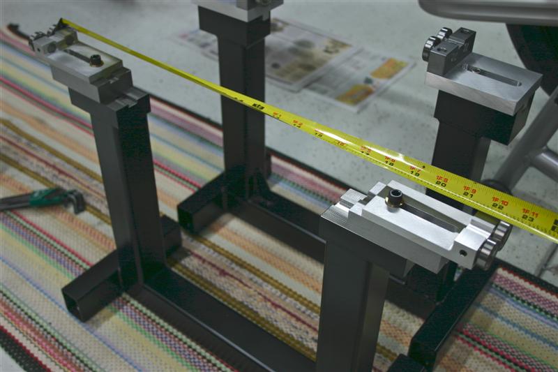

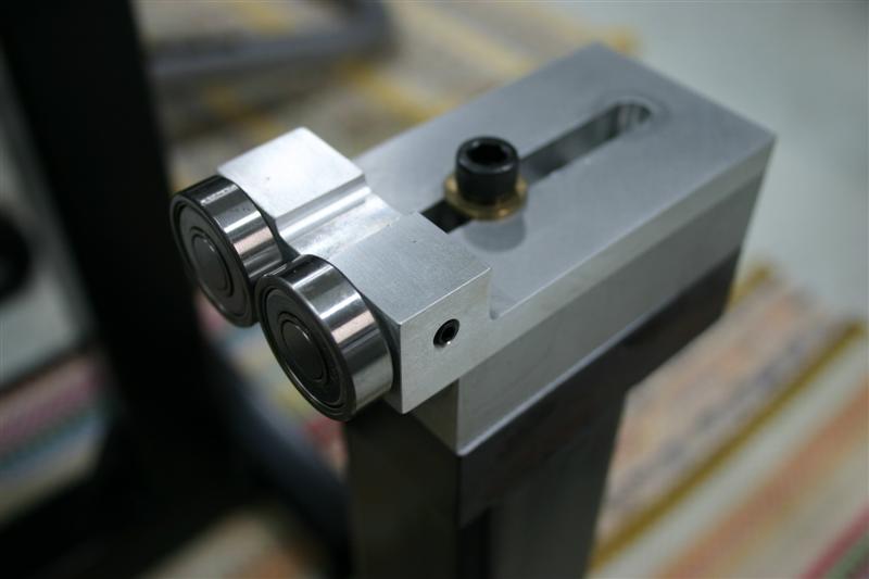

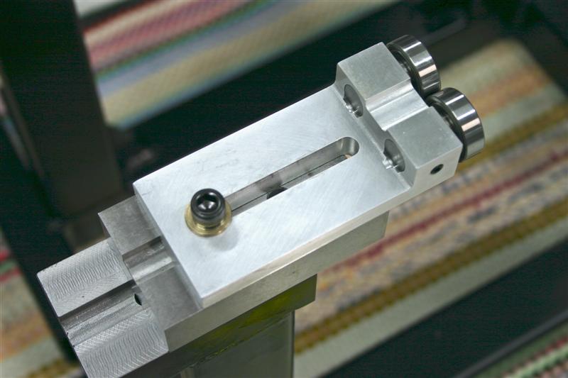

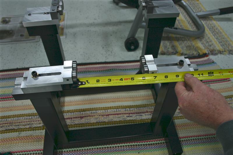

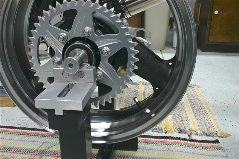

Here's a tool I designed/built for static balancing wheels, checking straightness of forks/axles, and for checking run out of cranks, etc. I made it adjustable for a variety of projects - may see the little 305 crank on it:

Thanks - I guess we can be called 'toolmakers' - sure helps with the right tools.G-Man wrote:Dick
Some excellent kit you have there and I love the balancing jig. Sometimes we seem to be making tools to make tools to do the job. It's all good therapy, though.

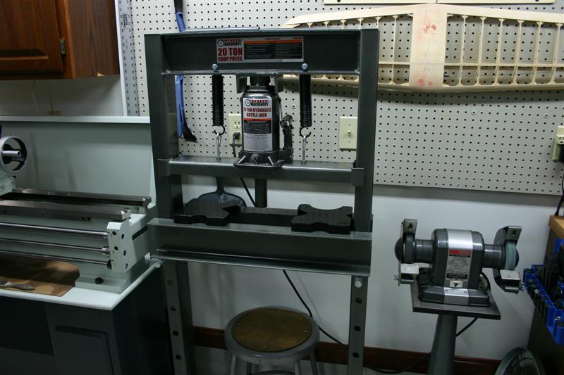

I got the 20T press, now need to pick up some steel to properly support the crank, and make an alignment fixture.

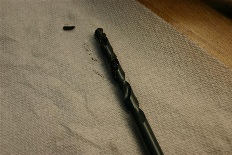

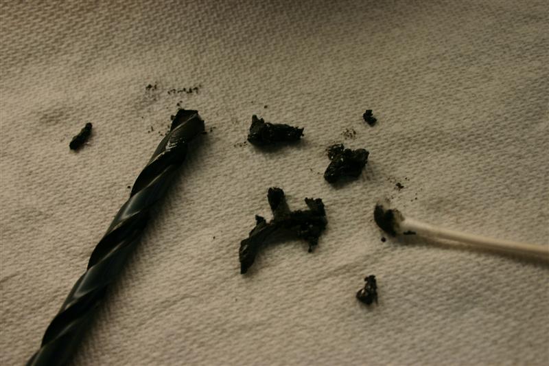

Pulled the crank pin plugs - the crud totally filled the flutes of my 8mm drill - this was the bike with 19K on it. The photo depicts only one side.

Yes - the crud in the big end oilways is always a bit of a surprise. The feed holes in the pin are cleverly placed so that you can collect a lot of muck before it gets out into the big end but imagine if you have a crank where that stuff has been drying out for years and then you shoot hot fresh oil in there.....
The 'slingers' on the inner crank web which feed oil from the main bearings to th ebig end will be equally caked up. That stuff is so hard that it looks like there is nothing in there until you poke a sharp tool at it. Again if the crank has been on a shelf for years it could be flaking off...
Make sure that you clean the jets in the center main bearing outers also. Many people think these bearings are splash fed but they oil pumped into the mains which then feeds the big ends and the small ends via the slots in the con-rods.
It's a clever design first used by Bugatti in the 1920s......
