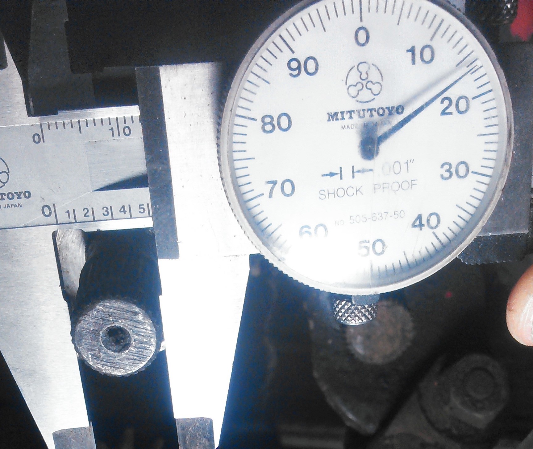

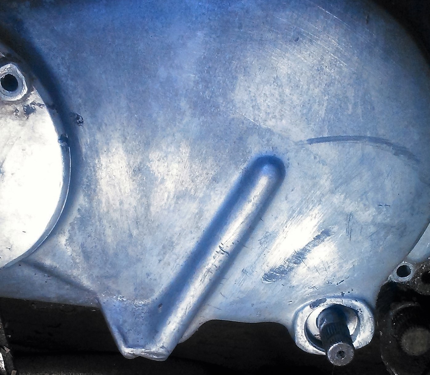

Post by randioury » Sun Jan 24, 2016 8:10 pm
Engine No.: CA77E-1026086
Frame No.: CA78*1026149
Caliper dial reads 0.5165"

Re: CA77 Shift Shaft Spline size with Photo
Post by LOUD MOUSE » Sun Jan 24, 2016 8:31 pm
Your bike is not a 1961 but is a 1965+ bike.
Your shaft at the clutch cover looks good to me but the splines look stripped to me.
Now show us the lever which you have and say doesn't fit. ................lm

Post by ggarton » Sun Jan 24, 2016 10:32 pm
Your bike 102XXXX, Is 1965-1967, I am thinking 1966. Anyway I has a couple of them, one off a 100XXXX and the other off a 102XXXX. They both look the same to me. You are welcome to have one. I live in central WV (not VA).
