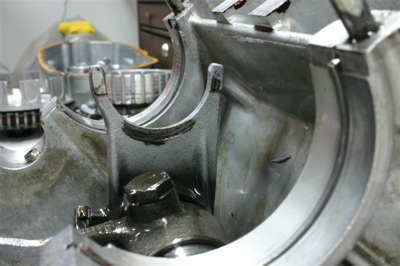

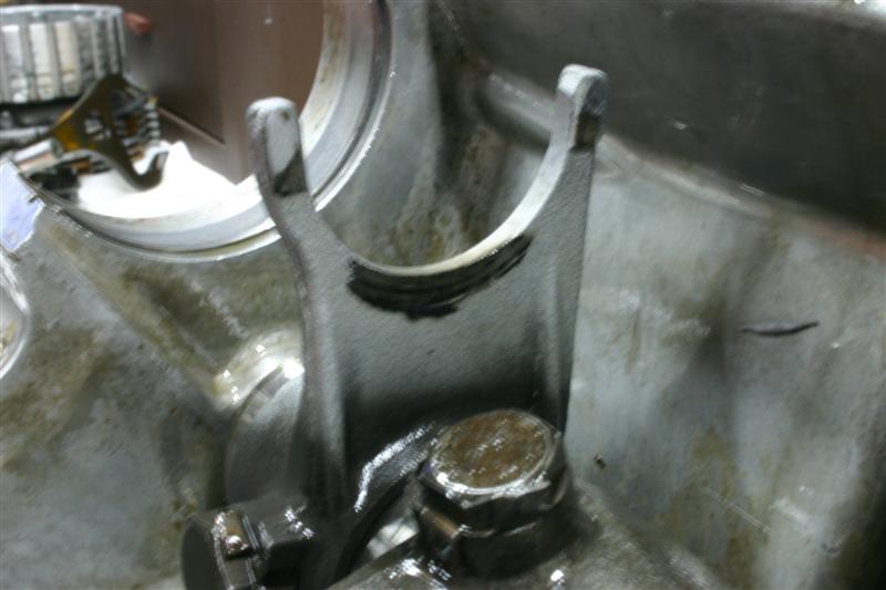

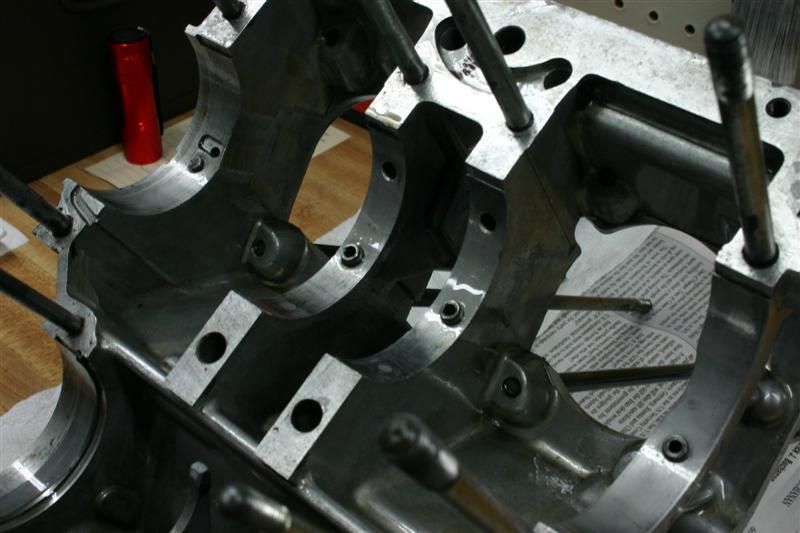

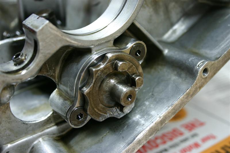

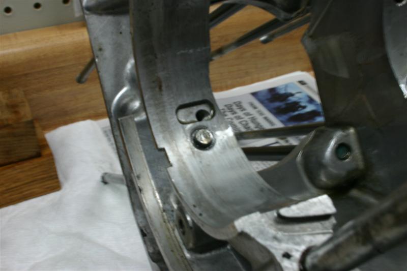

Post by Dick Eastman » Sat Nov 28, 2015 3:36 pm
I'll have a lot to go over - I went to loosen the LH nut on the cam before removing chain, and was not much more than finger tight; the cam chain had two master links... just a few things. Shifting forks burned - probably the excess end play in the drum from the inverted fixing plate. First gear bronze bush needs replaced; kick spindle bush shot, as well as the end of the kick start shaft that fits this; second gear dogs worn; second and third gears w/ fork grooves correspondingly burned....
I almost think it may be cheaper to find a low mileage tranny set than to try to replace individual pcs - the counter shaft where the sprocket affixes has some wear due to the sprocket fixing plate wearing and allowing the sprocket to have excess play on the shaft.
The locator pin is a 7x5 solid step pin - in good shape, as well as the hole; the other pins are hollow - all fit nicely into the case and the bearings

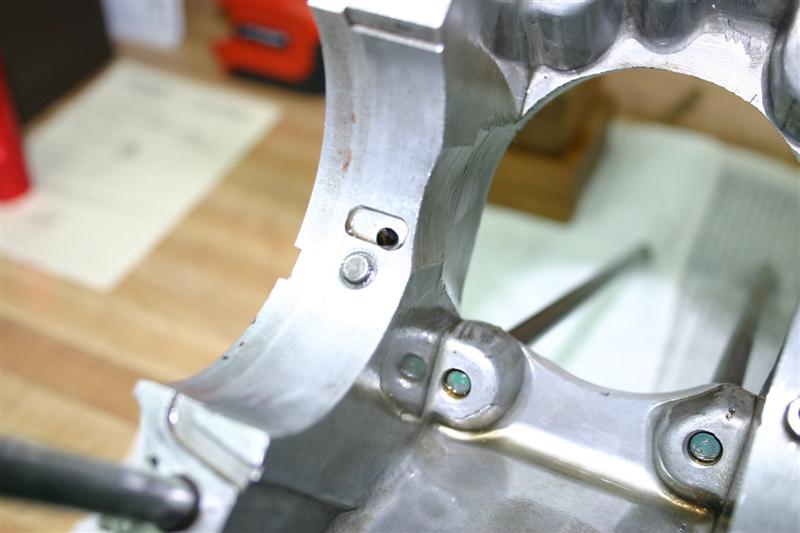

Post by Dick Eastman » Sat Nov 28, 2015 3:39 pm
One more attachments, the modified drum fixing plate
