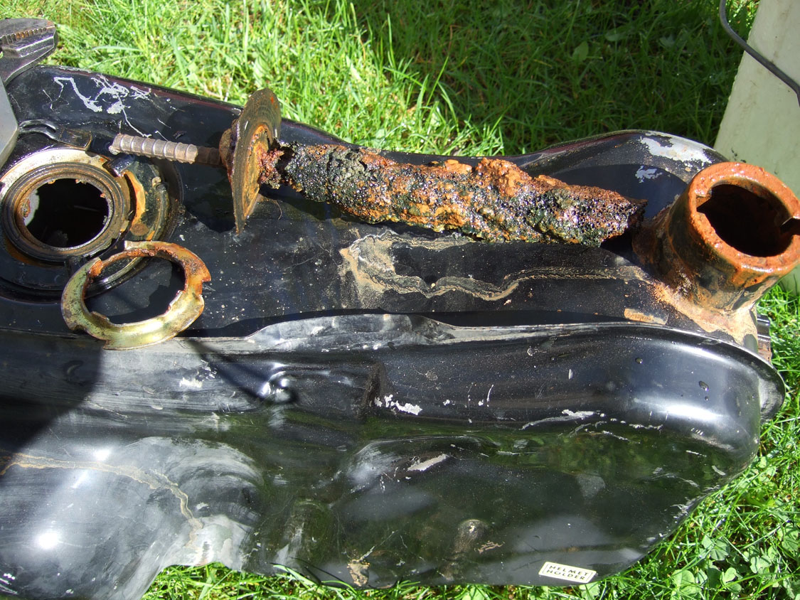

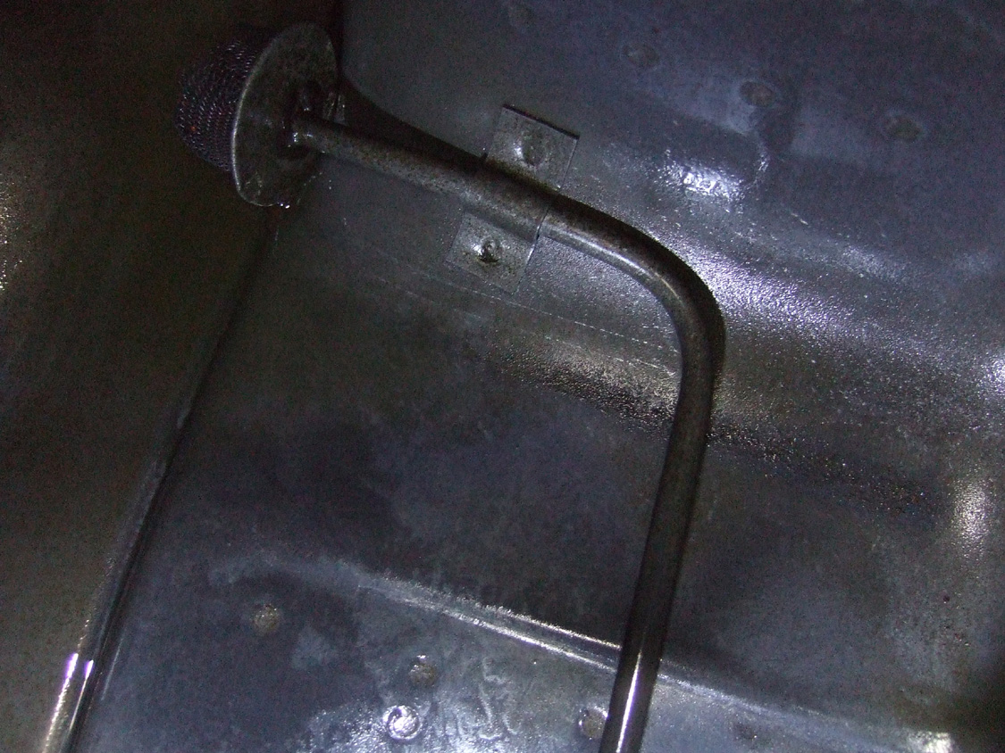

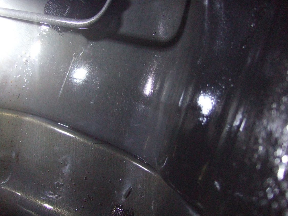

This is what I pulled out of a Goldwing tank via electrolysis:http://www.honda305.com/upload/h305_for ... 88_686.jpg
The interior of the tank looked like new afterwards.

What a great job, Mike! Look at the crud on that electrode....

WOW my 305 tank came out good but no way shiny like yours, great job

It took several days, pulled the electrode out and cleaned it several times. The hard part was fooling my "smart" battery charger into putting out some amps. I piggy-backed a run-down car battery on, in parallel, to get it to go.

What did you rig up to hold the electrode, Mike?
mike in idaho
Posts: 411
Location: orofino, idaho
Post by mike in idaho » Sun Nov 22, 2015 9:36 pm
I used a piece of plastic from the side of an antifreeze jug with a hole in the center to hold the re-bar. After doing the main part of the tank, I tipped it up to get the filler neck wet (it's higher than the sender unit) and moved the electrode there for another day.
