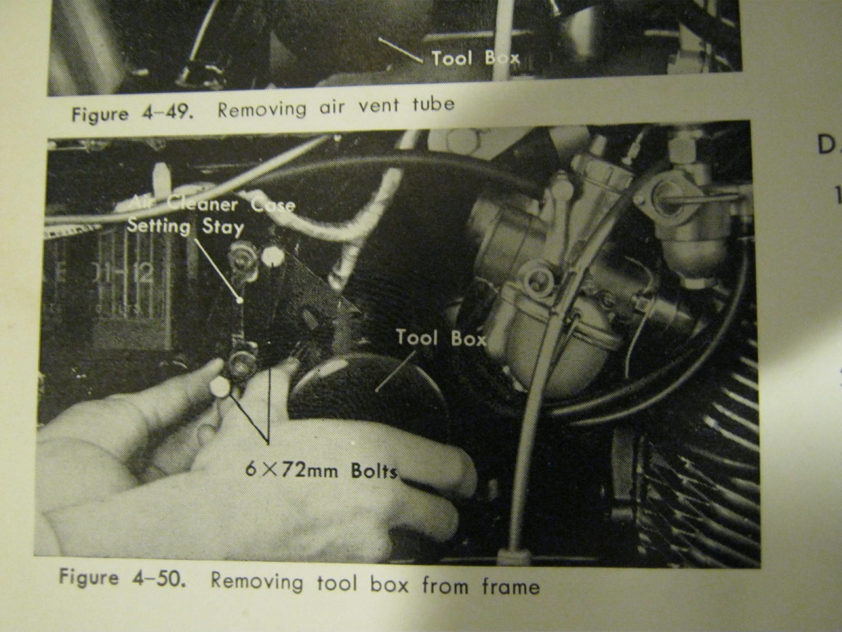

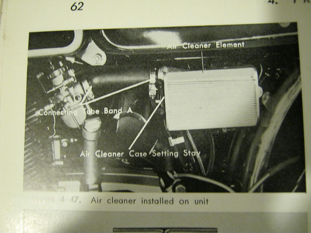

Hmm, I think I said "should" and didn't specify country. I have a set PW22's round bowl non-powerjet, sure seems to me the only likely candidate these could have come from would have been a '62 CL72. I didn't have the bike, only an early type1 CL head to which these were attached. Interesting the early shop manual shows PW22 powerjet carbs, you can see the hose hooked the the jet also a CB type petcock and band type clamps for the air cleaner rubbers. Most likely a proto-type model. Have had conversations with a couple people interested in my carbs. One fellow had a one bad round bowl on his '62 and was looking for a replacement.LOUD MOUSE wrote:WRONG!

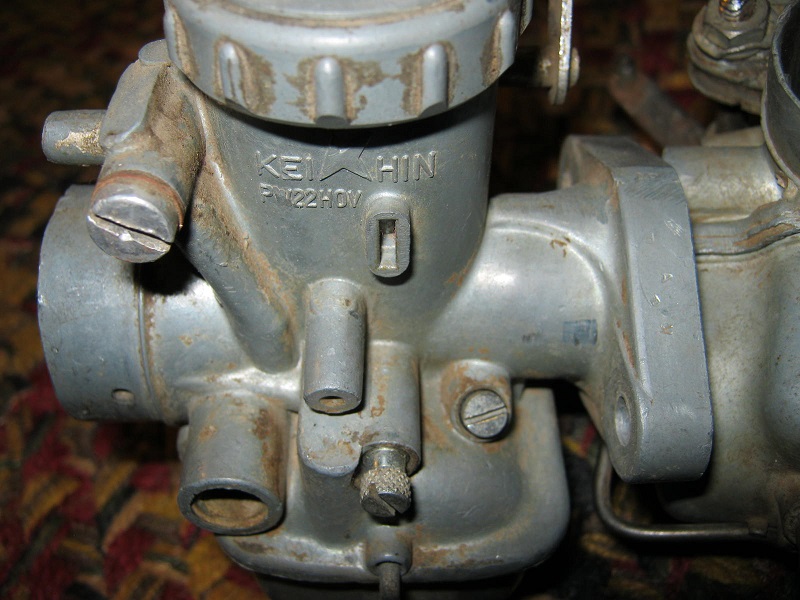

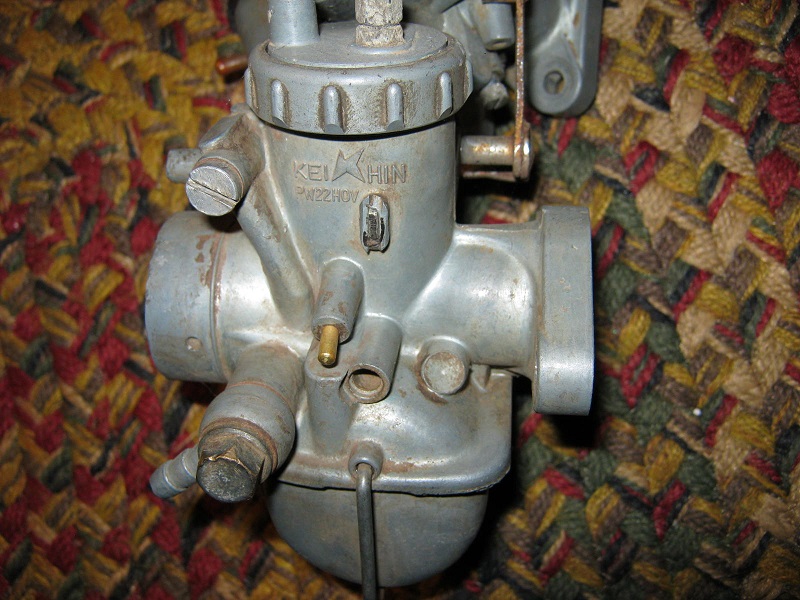

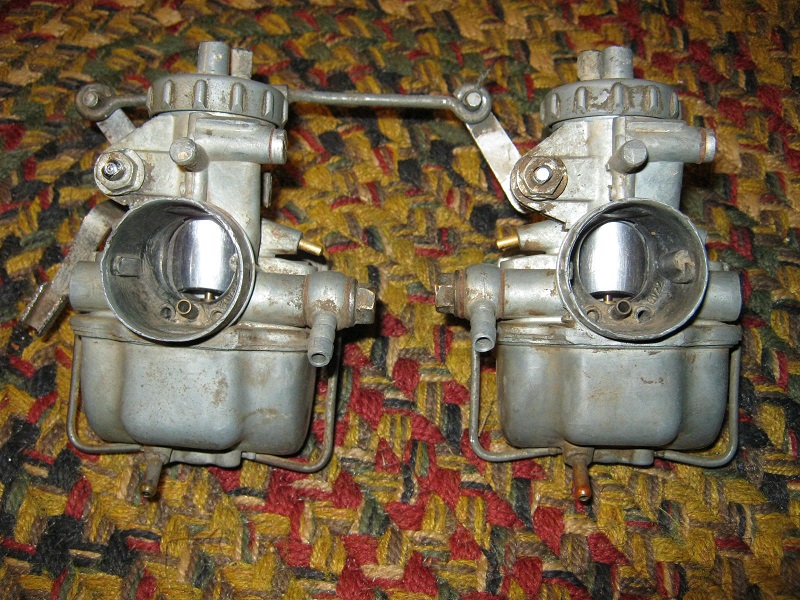

I know of the number you are referring to.
These carbs are not marked, they are not one, but a pair, right and left. Were mounted to an early CL72 type 1 head and used. Pictures to follow.
I'll agree on the parts book "drawings". I'll also agree on the shop manual pictures.
With this pair of carbs in my hands I'll keep an open mind.

I have the same L/S carb (flat right and left angles at the front not smooth round like the other carbs of that era.
Mine is stamped CL72.
Also take a look in your shop manual at pages 118' 119, and 120.
Also page 38 for a good laugh.
May we see a pic of the frame number?
Any chance you have a CL250???
Did you notice the black tube at the top rear which was installed on the CB72 power jet carbs?. .................lm
