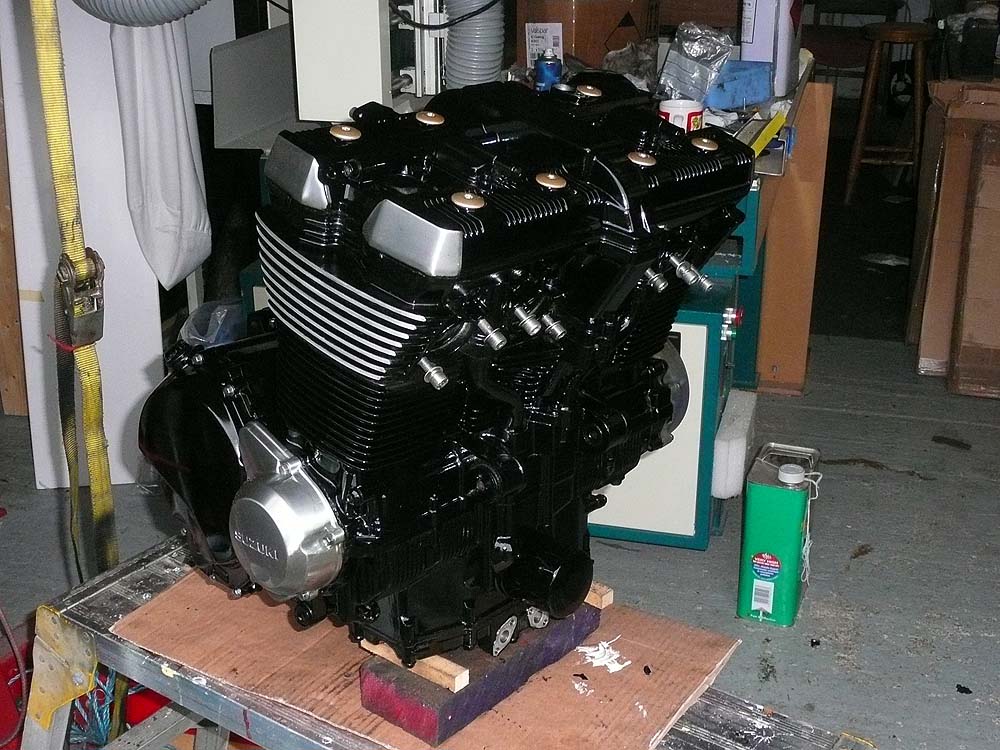

After rebuilding one of my 1400 engines (aqua-washed whilst in bits ) I painted it with 2-pack satin acrylic, it stands up to the heat just fine.
- Engine31.jpg (153.46 KiB) Viewed 5769 times

Looks awesome modelman! Really like how you did the fins, am considering a similar look on my 305.
My question though was not if it would stand up to the heat but the best method for curing the paint. As stated above, I've heard of people putting their painted cases in the oven at around 350 degrees to cure the paint and have also heard of people painting the engine, then starting it and letting the heat of the engine cure the paint.
The answer I'm really looking for, I suppose, is which method would be more durable against typical wear and tear?

That's the beauty of 2-pack acrylic, 2-pack =paint & hardener, you can blatt the stuff 1/2" thick if you want & it will still dry/cure/harden all the way through in about 1/2 hour!!rideordie wrote:Looks awesome modelman! Really like how you did the fins, am considering a similar look on my 305.
As for the fins, that's how the top 8 are supposed to be on the 1400, the head is painted then machined off, I did the same!!
