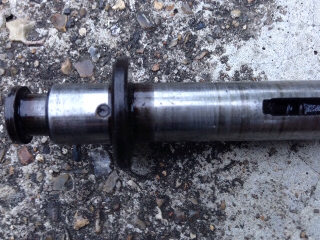

Picture of pin

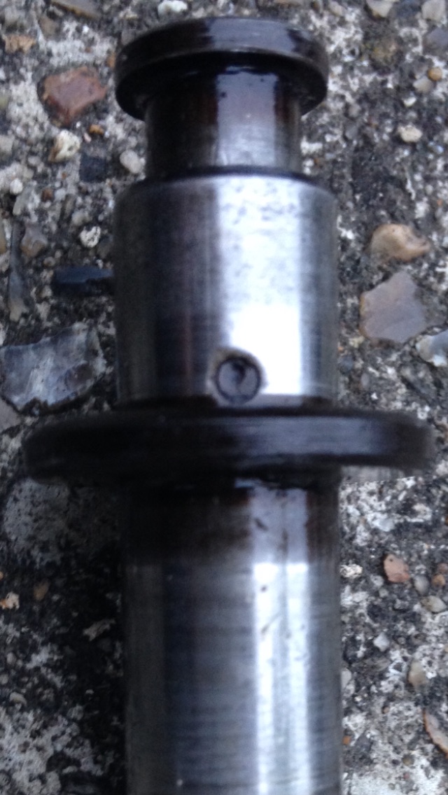

Regarding the original leak the small o-ring inside the mainshaft was slightly damaged and worn and the oil guide pin (pic attached) was broken. I'll replace the o-ring and the clutch push rod oil seal (think its called o-ring 8216) anyway. But what is the purpose of that pin? I'll get myself a manual soon. I expect the engine is coming out, although it clearly had been recently split and the cam chain is certainly new.
Post by G-Man » Wed May 27, 2015 4:10 pm
The pin retains a spring inside the part.
CharlesM wrote:Picture of pin

Post by CharlesM » Wed May 27, 2015 4:13 pm
Thank you. Looks like I'll have the earbox out then!
Spring is in there fine so maybe just the push rod o-ring. It should be an energised seal.
