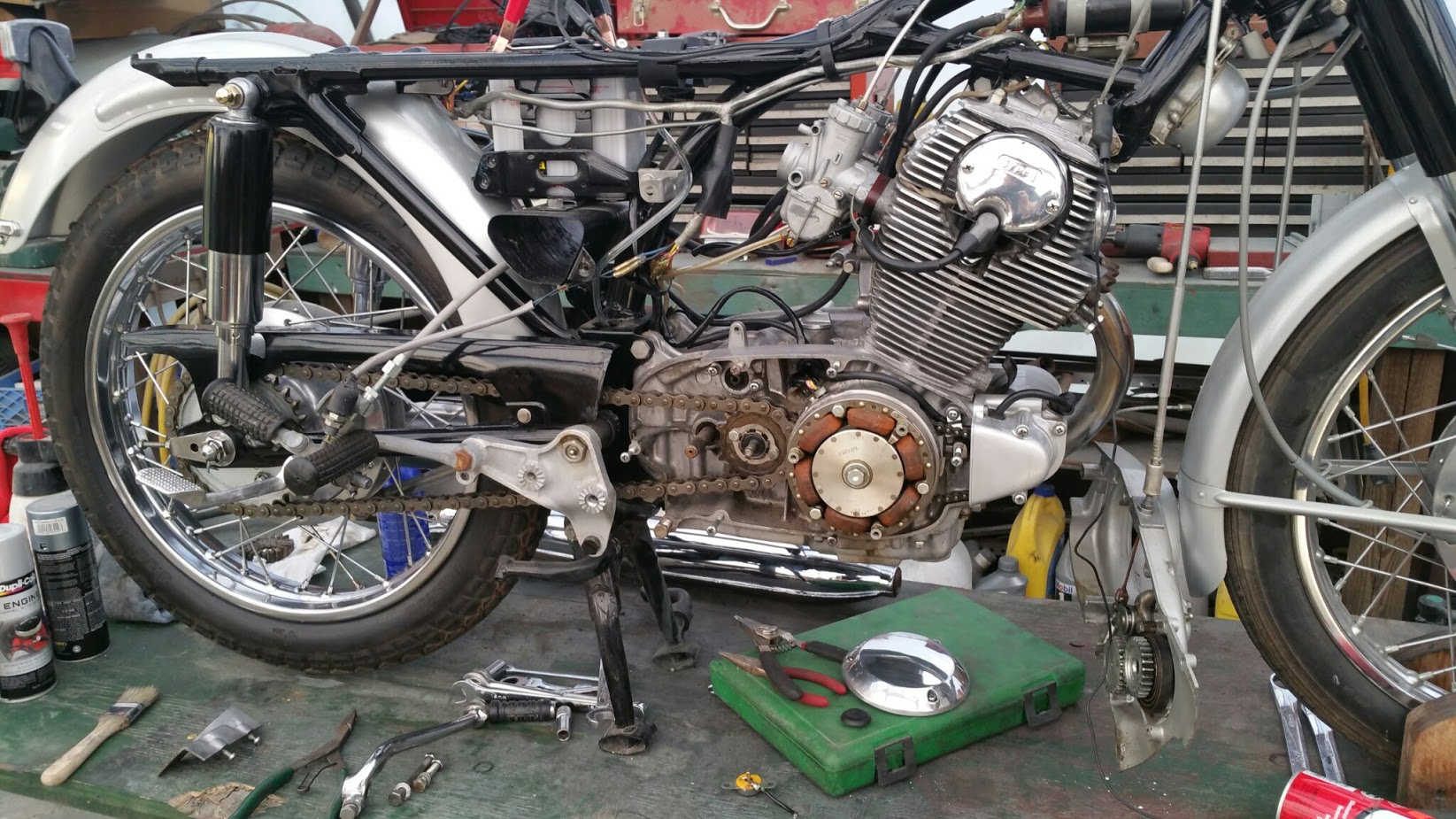

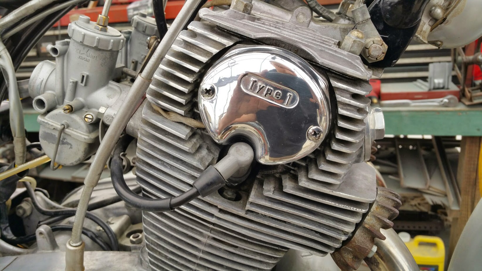

I started repolishing the stator cover
It looks okay, not as good as I had hoped, there's faint tiny scratches still in it. I might 400 , 600 , 800 and 1,000 it.
You can see the fins will polish up really nice on the motor, I started polishing them with a little dremel wheel after I took this picture.

Had some free time Wednesday night I pulled the case cover on the right hand side.
Wanted to check my clutch cable, and also wanted to investigate my neutral switch not working.
I pulled the neutral switch, if I ground my test light to the ground that attaches by the coil, and ground the wire to that attaches to the neutral switch the light works. I checked and took apart the neutral switch, the inside was toast the spring fell apart, and the contact point... I tried to solder it, but it wasn't successful. I ordered a NOS switch from eBay yesterday.
Was a good thing I pulled the cover anyway, because the wires that run to the stator , the jacket was making contact with the chain!
I made a rookie mistake, not sure if I needed to do this, but I took the kick start circlips off and now I need to re-align the kick start spring. It doesn't seem to difficult.
Put tension on the spring, and align the two marks on the sprocket, then slide onto the shaft?
Engine is cleaning up well, I'm still going to continue polishing the fins. I'm thinking about painting the bottom portion of the motor black with polished fins, and the jugs the aluminum with polished fins. I'm still up in the air about that though.
