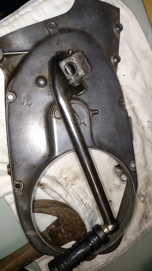

Post by connor1 » Tue Apr 28, 2015 10:12 pm
Pics
cover with lever.jpg (128.47 KiB) Viewed 4238 times

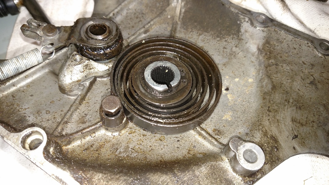

Post by connor1 » Tue Apr 28, 2015 10:16 pm
another pic
coil spring.jpg (162.57 KiB) Viewed 4232 times

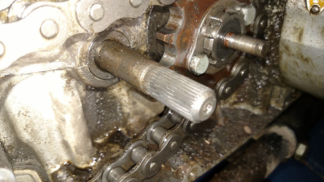

Post by connor1 » Tue Apr 28, 2015 10:17 pm
spline

You should pull that piece out of the cover and check it out, if slipped on the spline it's likely cracked.

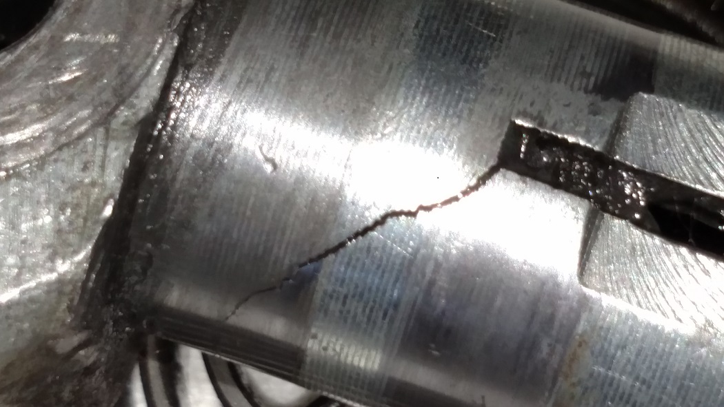

+1 with Mike................remove the 10mm cap-bolt to release any remaining spring-tension............then the clip...........Examine closely..........cracks are sometimes hidden. Pay attention to the spring for proper re-assembly.

Well guys you were exactly right! Here are a couple of pics of the cracked knuckle.
CL72 kickstart knuckle resize.jpg (128.38 KiB) Viewed 4085 times

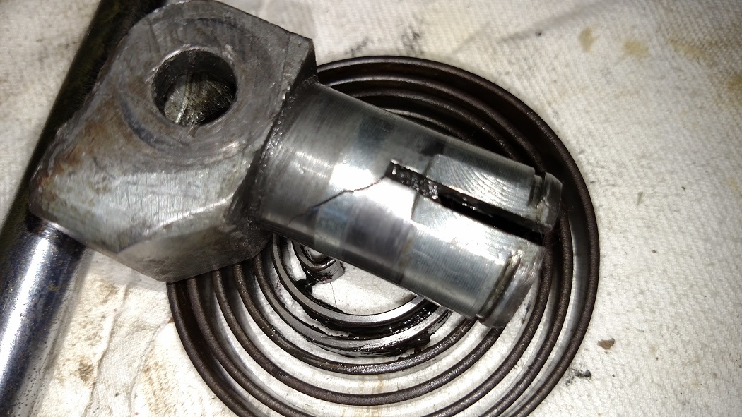

Post by connor1 » Tue May 05, 2015 7:43 pm
and another...
HondaCL72 kickstart knuckle crack resize.jpg (87.9 KiB) Viewed 4080 times
