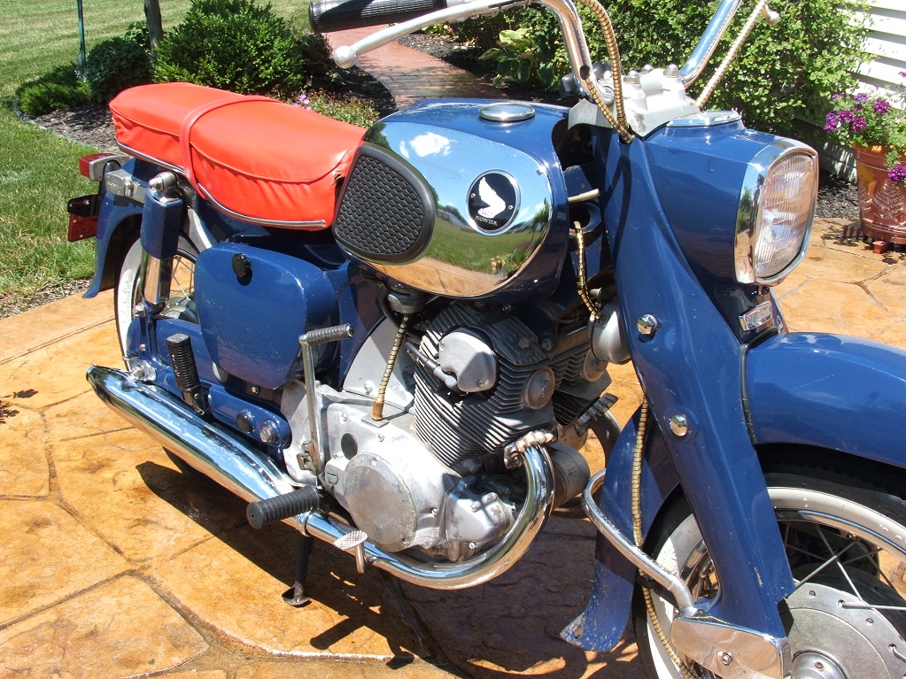

HRH - Those headers do look a little too "loopy" for lack of a better word. Here's a picture of what a stock one looks like. Over the years, the bends did change a little, but I've never run across a set that hit the front suspension. Yours look like they are sticking too far out of the engine though. Are they installed properly? I think I see witness marks where the clamp used to be. Also, if you have stock mufflers, they shouldn't be lining up too well at this point.

Very interesting. Those do look FAR different than mine... I will take them off tonight but I dont think the shims go in a specific way? I dont have the stock muffler but have those knock off pipes for them. They fit fine but you can adjust them during install so probably wouldnt change anything.
Plan is to: 1. remove headers and check install. 2. try to find an extra header which I think I have... Somewhere at least.
