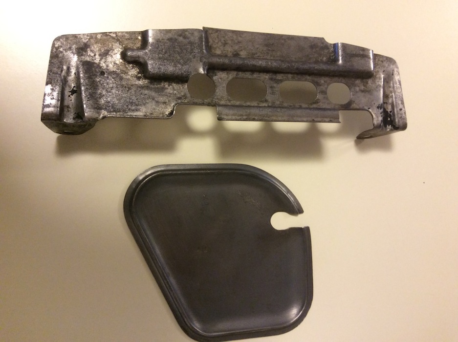

So-so results with the other 2 pieces de-rusted today. I'll take the rest of the paint off of the tool shelf tomorrow and put it back into the electrolysis bath with steel electrodes for a few hours tomorrow. The air filter door is okay.

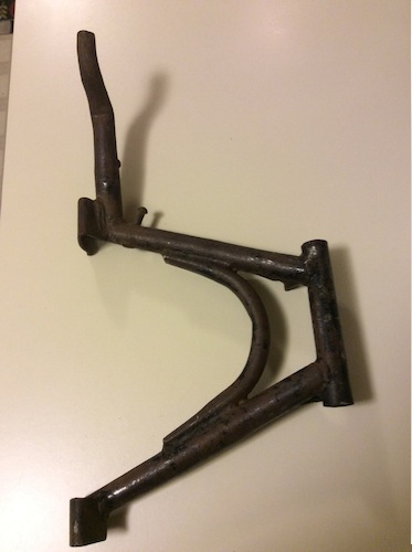

I'll probably start de-rusting the center stand tomorrow, but first I'll take a "before" picture for later comparison.

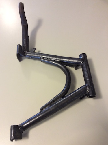

Making a little progress today. I finished brushing the parts de-rusted yesterday and gave them a coat of primer. In the electrolysis bath today is the center stand, the collar and the bolt.

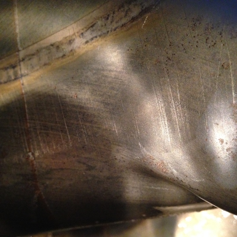

I also drained the Evapo-Rust from the gas tank and I can say that I'm well pleased with the results. I couldn't get a very good photo of the inside, but it's pretty shiny. The directions for the product call for a water rinse and, to prevent flash rusting, to dry it, then put some product back into the tank to wet the sides. Excess is to be drained and the wet sides allowed to air dry. I chose to follow that route and will rinse and dry the tank again when it's put into service. I'll keep an eye on it just to see if any rust develops.
Edited Later In the Day: Added "after" center stand photo
