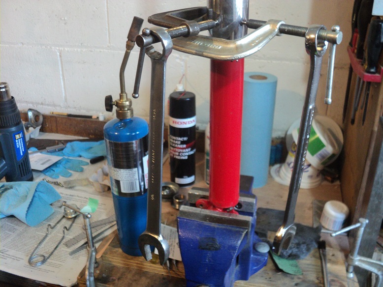

Post by R100 » Wed Mar 11, 2015 4:22 pm
Made a second clamp to spread the grunt around more evenly.
Hot air did not work, so I used propane.
The big spanners were positioned for leverage.
The first one was a b****, the second one easier.
Spray paint is an excellent substitute for Loctite.
Looks like something out of a cartoon, but it worked.
Anything weird to look out for when I take them apart?

Post by G-Man » Wed Mar 11, 2015 4:29 pm
R100
That's a magnificent piece of improvization. Something to be proud of! So much better than a strap or chain wrench.
The tube should just pull out, but if it doesn't you may have the inside of the slider dimpled by someone using an over-long fender bolt. This can sometimes be dealt with by working the stanchion like a slide hammer. If not you may need to damage something to get them apart. I had one that was so bad I had to drill through the bottom of the fender mount hole to remove the dimple.
Good luck!

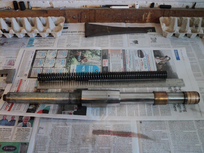

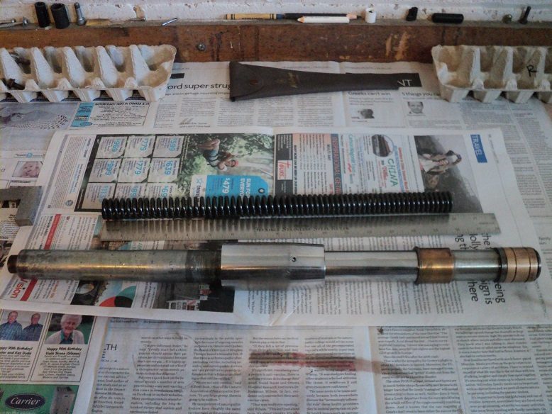

Post by R100 » Thu Mar 12, 2015 2:48 pm
Stanchion tube slid out of the lower with no problem.
Not sure how to continue in order to remove the chrome housing.
Also, my online shop manual gives a spring free length of 278.8mm. Mine measure 403mm (15 7/8").
forks 001.JPG (94.72 KiB) Viewed 3239 times
Post by G-Man » Thu Mar 12, 2015 2:52 pm
R100
You must dismantle all of the circlips and bushes from the bottom. Keep a careful note of where each part goes AND which way up it is. The damper valve (steel ring) has a chamfer on one side only.

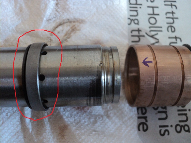

Post by R100 » Thu Mar 12, 2015 3:33 pm
G.
Does this ring come off? It does not want to move.
forks 003.JPG (62.06 KiB) Viewed 3231 times
Post by G-Man » Thu Mar 12, 2015 3:47 pm
Yes - its supposed to be free as it provides the bump - rebound damping function as a valve over those holes.
