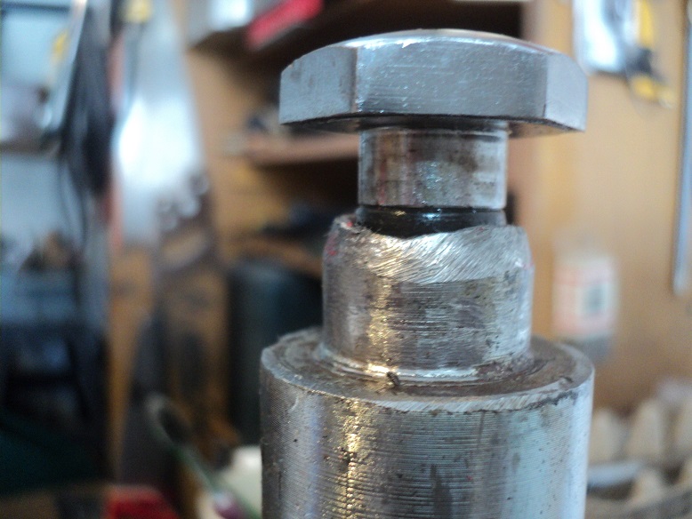

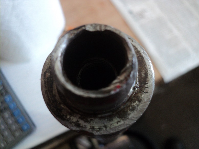

Here is what I discovered someone had done to the top of one fork tube.
Why is it that some people think they instantly become motorcycle mechanics the day they purchase a used bike?
I will be looking for some Type 1 forks on E-Bay. Hopefully I can assemble 2 good forks from 4.

Post by G-Man » Mon Mar 09, 2015 9:03 am
I realise now that the necessity came about because the alloy fork bottoms do not have the axle offset from the centreline like the early steel lowers had. The split clamp with two studs at the bottom meant that it was impossible to use the same geometry for the triple clamps.
Every day is a school day.....
R100 be careful when buying the early forks. You need the ones that are post '63 as the very early ones had fatter legs (so to speak).... :-)
