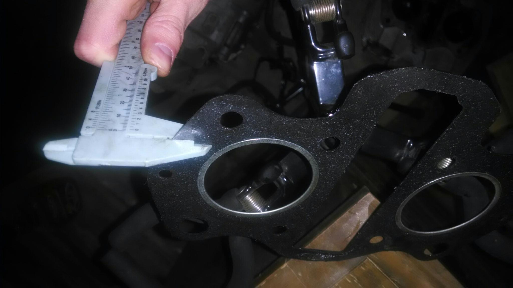

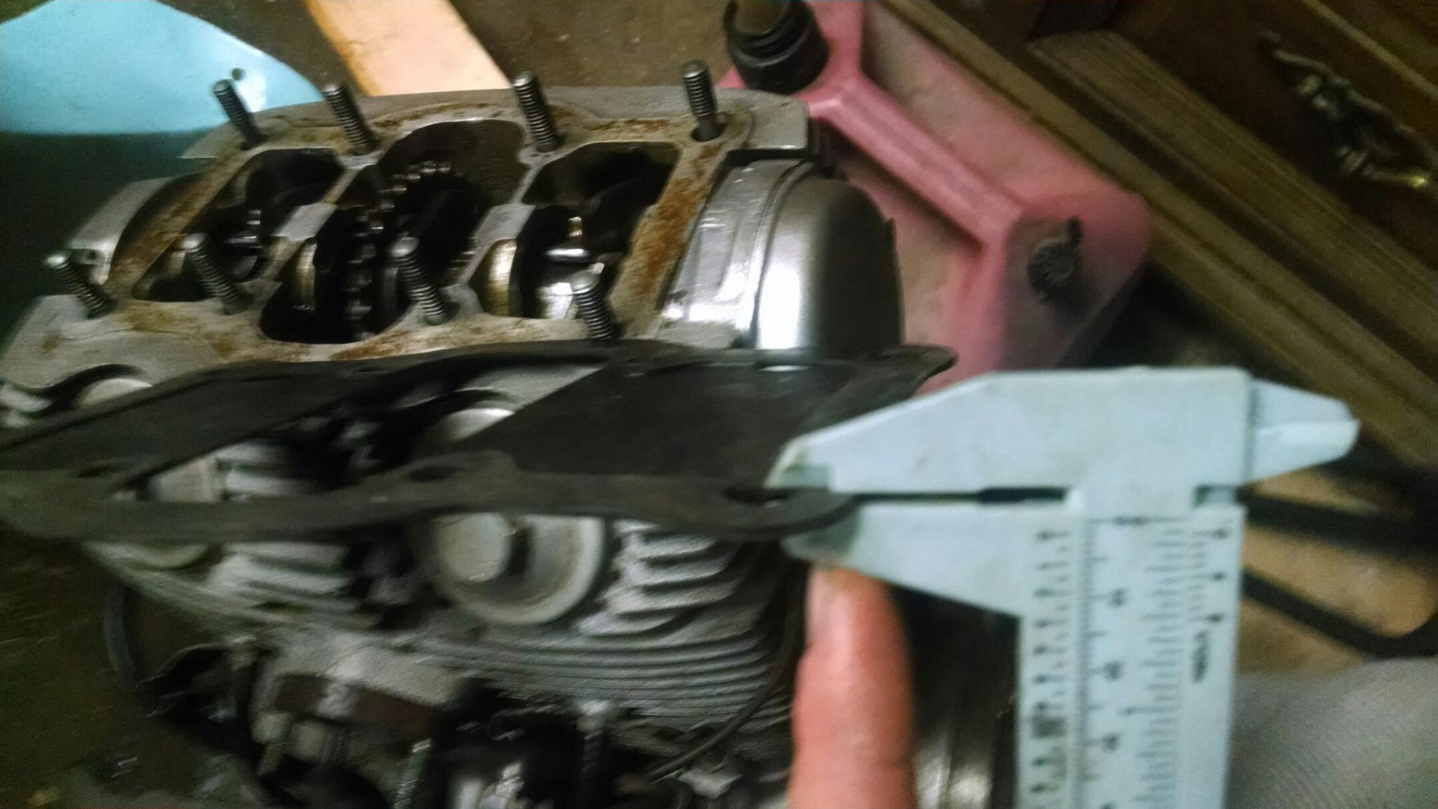

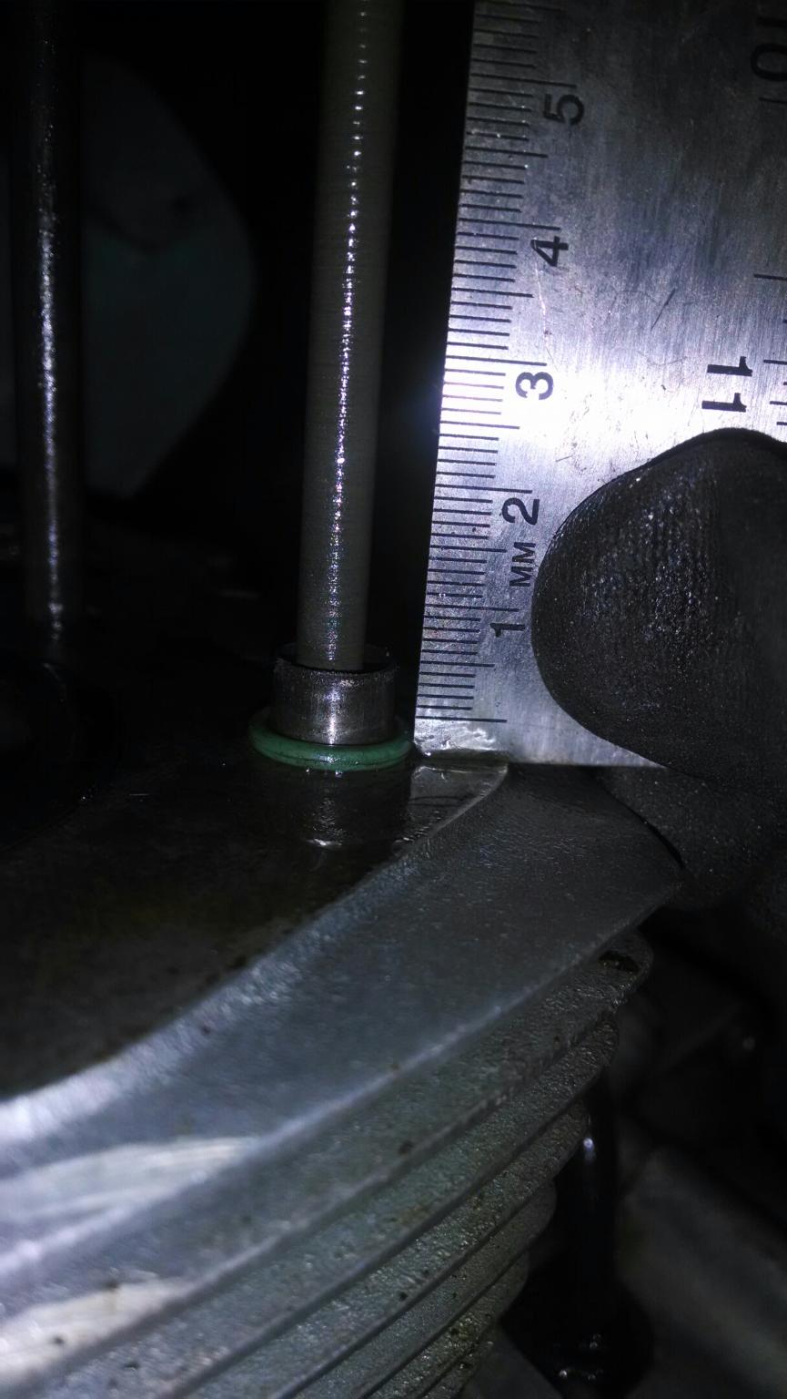

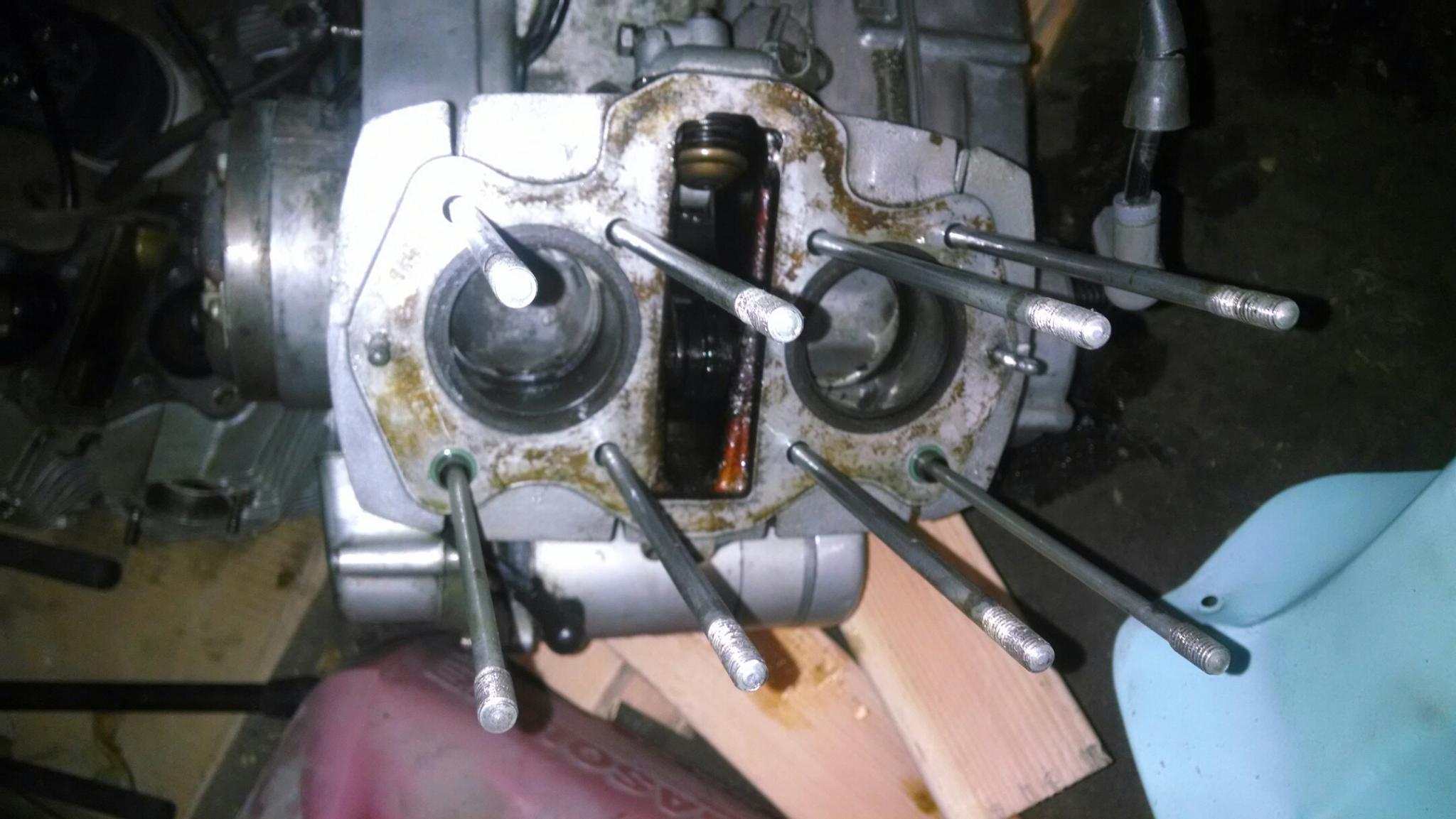

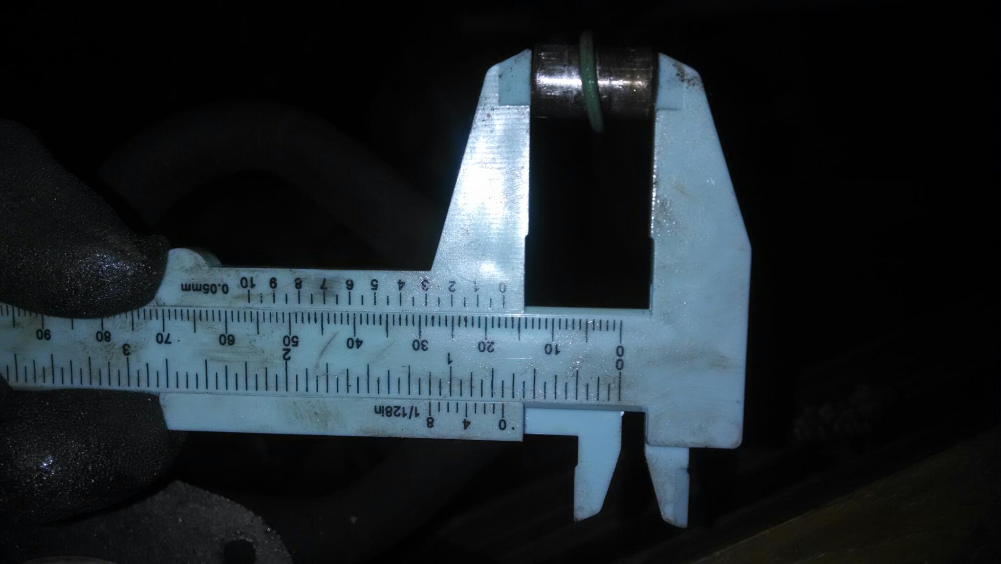

Okay, here's a big picture dump and explanations.
So, I accidentally crushed one of my knock pins so it looks like I'll be hunting one of those down. Damn it.
But, there's measurements here for the top cover gasket (which is like two gaskets formed into one), measurement of the knock pins coming out of the head, measurement of the head gasket is here as well and seems fairly small and measurements of the knock pin itself.
I also found that my cylinder studs, that the inner two are taller than the outer two. Not sure if that's supposed to be the case.
There's also some gasket gunk that I need to clean off of both surfaces, that may help as well.
Let me know if this is helpful?
