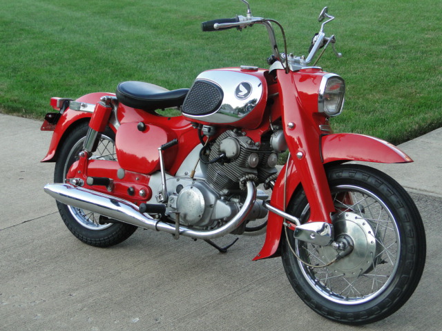

I actually like the look of the blackwalls better. To me, the whitewalls seem to draw attention away from the unique features of the CA. There's a few more good choices in blackwalls too. Pictured is a "Goodyear Ribbed Black" on the front and a "Firestone Motorcycle Rear" well, on the rear. Got these from Coker in spring of 2013, but I think they're discontinued now. They might still have stock though, worth a call if you want a set. At that time, $145.99 to my door including tubes and rim strips. I have also had the Firestone zig-zags on another Dream and I can say for sure that these (like any other tire probably) have a much more confident feel.
-48
