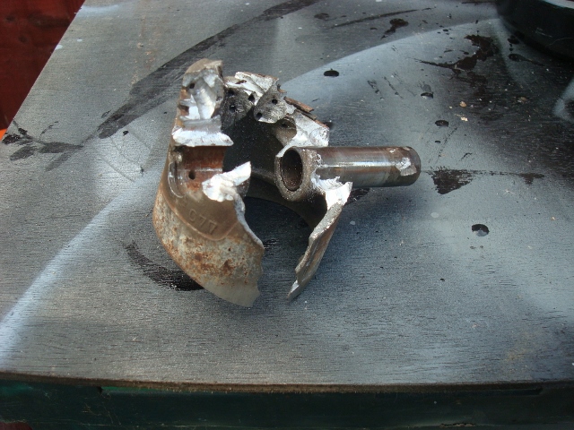

Post by pieeater » Tue Sep 30, 2014 12:37 pm
Ha ther's your problem sir
Had to bite the bullet and drill it out.
Tried everything used a bottle of map gas two tins of penetrating oil, made a pusher didn't move a thou.
Couldn't even get the little end pin out had to drill that out.
There is no sign of corrosion in the barrel and the other cylinder and piston is fine.
It must have overheated and seized out of shape.
I cant see any over size markings on the piston top where are they normally.
DSC03953 (640x480).jpg (62.21 KiB) Viewed 4360 times
Post by G-Man » Tue Sep 30, 2014 1:18 pm
STD bore is 60.00 mm or thereabouts....
That piston looks like it will clean up nicely..... :-)
Send me a PM and I'll let you know what parts I have.
How about a pic of the rest of the bike?

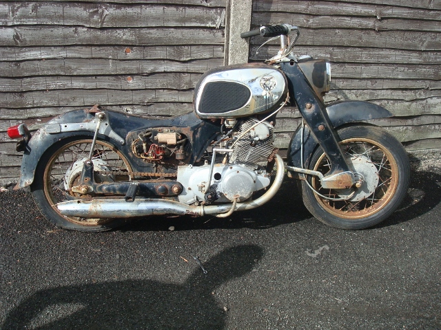

Post by pieeater » Tue Sep 30, 2014 5:09 pm
This is my bike as bought last week
I think I have managed to compress the photo
DSC03947 (640x480).jpg (96.62 KiB) Viewed 4330 times
Post by G-Man » Wed Oct 01, 2014 12:17 am
Looks like a pretty good start!
garncarz
Posts: 210
Location: York, PA
Post by garncarz » Wed Oct 01, 2014 6:35 am
I like the hard tail modification!
