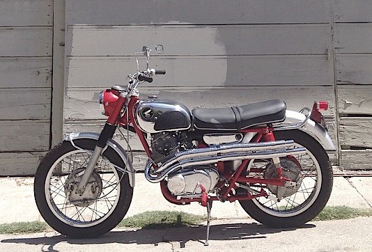

The attached picture is the bike as it looks today, it's a bitsa bike, and thanks for the exhaust pipes they worked out well.
- CL77.jpg (58.79 KiB) Viewed 3009 times

You seem to have a CL160 front fender on that bike. It's designed for an 18 inch wheel rather that the CL77's 19 inch one. It could be dangerous if it snags on the tire at high speed....
