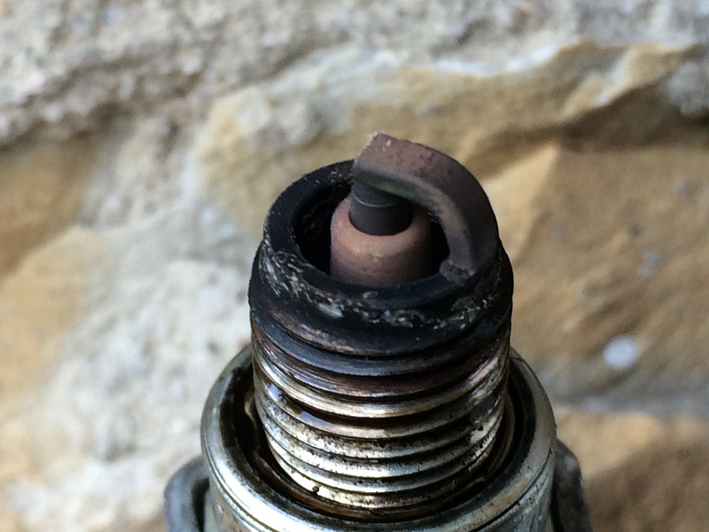

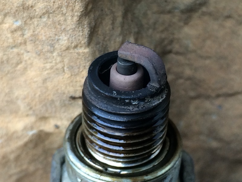

Post by garncarz » Wed Jun 18, 2014 6:40 pm
These are the NGK D8's that I just pulled. I don't know, but they look pretty good to me. Opinions?
IMG_2915 small.jpg (65.39 KiB) Viewed 2859 times

Post by G-Man » Thu Jun 19, 2014 1:53 pm
They look pretty good, although 2911 looks the weaker of the two....
Have you tried putting the choke on a little when it appears to lose power?
Post by brewsky » Fri Jun 20, 2014 5:20 am
+1
Stock slow jet was 35 on mine.
If you still have the original jets and they are not damaged, I would just clean them good and re-install them and go from there. They are better quality than the replacements, and don't generally wear out.
It is common not to get any increased power from the last 1/4 throttle at given load conditions, even on new bikes.
Air filter clean?
Plug chops are best done with new plugs, as deposits from many miles of part throttle running can cloud those from a short distance at WOT.
