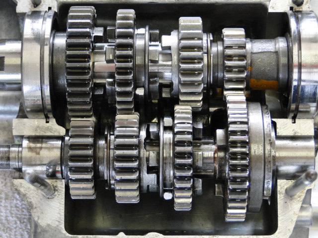

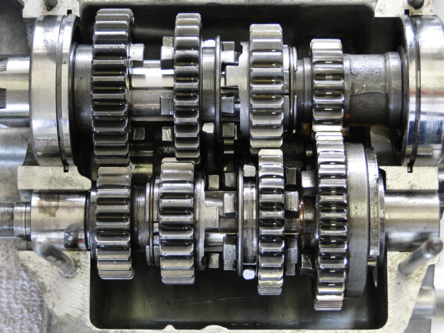

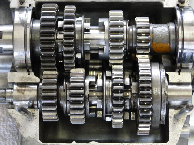

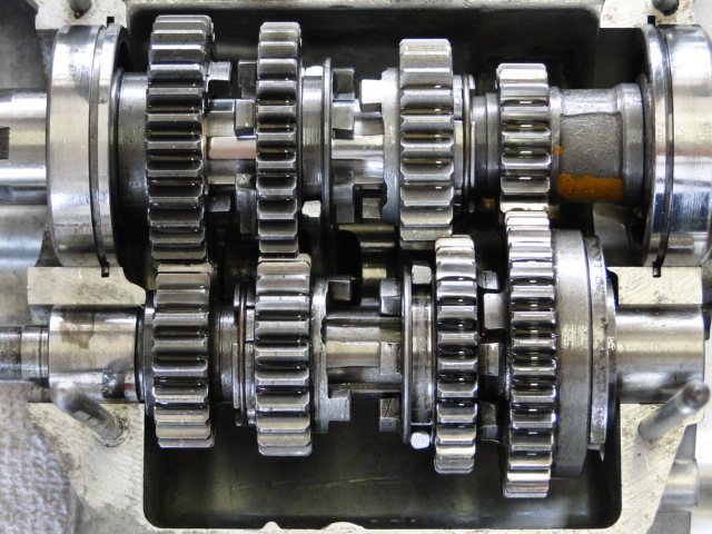

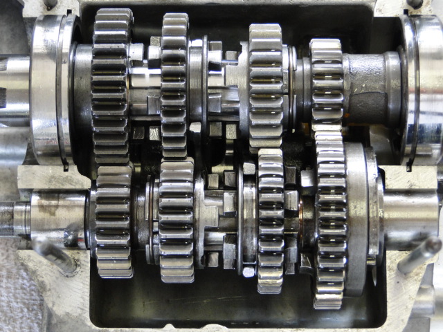

Just so there's no confusion when you search for these, they are "offset" cotters and they come in two varieties, .020" (23941-259-305), and .040" (23943-259-305). I'd go straight to the .040's. None are available from Honda, but they are out there. Try hondarestoration.com, Western Hills, hondanuts.com, etc. Here's a series of snaps with the .040's installed; the offset cotters just move the stationary gears closer to the sliders they have to engage with.
5 Fourth.JPG (67.03 KiB) Viewed 3495 times
4 Third.JPG (67.37 KiB) Viewed 3495 times
3 Second.JPG (67.37 KiB) Viewed 3495 times
2 Neutral.JPG (66.82 KiB) Viewed 3496 times
1 First.JPG (67.43 KiB) Viewed 3497 times
