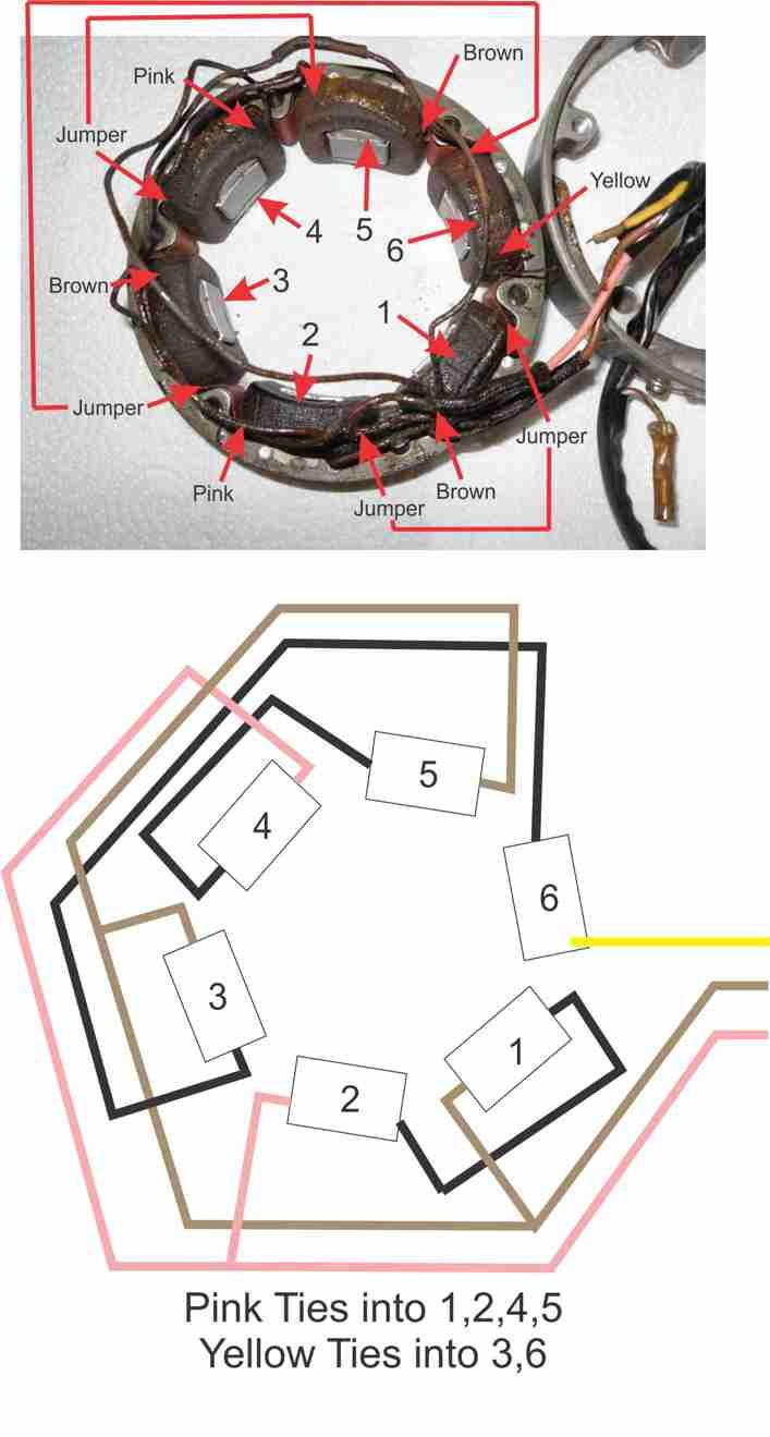

Hello Cadman,
Thanks for clarifying the diagnostics for me.
Checked the stator today:
1. yellow + pink= 0.0acv
2. yellow + brown= 26.5avcv
3. brown + pink= 26.5acv
I found my spare stator Saturday and also installed it with the very same results.
Does this mean that the stator is cooked?

Where are you testing - at the plug down by the case or at the rectifier?
Well after your email I re-looked - The instructions I gave you were for a standard three wire alternator. After looking again at the wiring diagram and the diagrams I made it appears your testing may be okay. There are six coils in the stator it appears that all six are tied together and end up in the brown wire (it now becomes a common wire for all 6 coils). The yellow wire then taps into 2 coils for the rectifier (yellow) and 4 coils (Pink wire) for the headlight "on" condition. The bottom line is it seems that brown to yellow or pink should read voltage and yellow to pink would not. Exactly what you found. The fact that a second stator reads the same almost confirms that. I am about 90% sure this is correct. Maybe someone else can add to that.
It looks like that I was probably incorrect.
- stator diagram1.jpg (72.17 KiB) Viewed 2364 times

Judging by those ACV readings I'd say your stator is ok. Seems to me your rec has pooped its panties. Here's my colour wiring diagram; the colours make it easier to follow.bikedoctor99 wrote:Hello Cadman,
Yikes, sounds like total loss for now.
Allan
