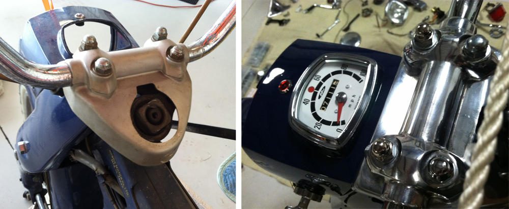

More before & after pictures
Polished aluminum, new paint and rebuilt speedometer

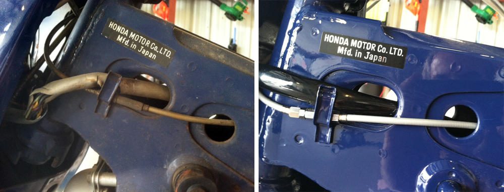

Wiring harness, clutch cable & forward frame

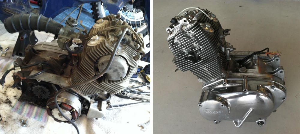

Engine before & after. No silver paint here. The cylinder and head were vapor honed, and the cases were polished.

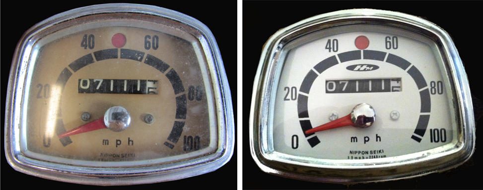

Speedometer, before and after rebuild

Where did you get the speedo decal at? Also was wondering why one of my speedos have the red dot in the center and the other does not? Was the wiring from scratch or do you have someone that makes them?
