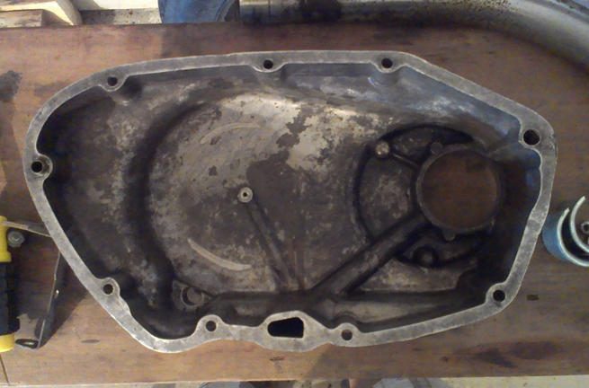

I think that I have gotten it all off. There is nothing but bare metal all away around.
I used a large putty knife just like Goodysnap suggested. It took a little elbow grease, but it worked great!

Looks pretty good. I see some gouges in the cover where it looks like someone pried the cover off. Make sure that surface is flat. Sand it smooth with emery cloth or sand paper if there is any high spots. You might put a dab of sealer at that location or fill the gouge with JB weld and sand it flat.
