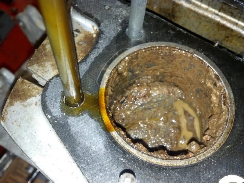

Pulled the engine apart. Only one stripped bolt hole, no broken bolts. The one cylinder was UGLY, full of muck (from the oil soaking it for a long time) and rust. I managed to get it down enough to pull the wrist pin and lift the barrel off. I wire brushed the bore and pounded the piston out the top. The rust pits were so bad in the cylinder that it can't be rebored, and it was standard! The other cylinder will take a bore, so I have a NOS coming from eBay to replace the bad one. The old one came out pretty well once I got it warmed up to about 200 degrees, or a little more. Infrared thermometer came in handy.

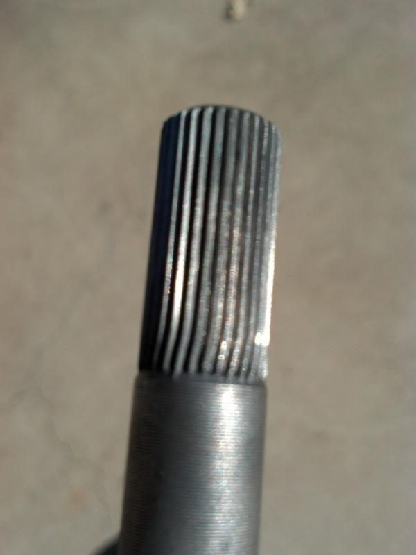

The brass bushing is nearly gone. The only other problem with the engine/transmission assembly is the kickstart shaft has about a half spline twist in the splines. Someone got a little too forceful while the engine was frozen. Question is, will it last? The shaft otherwise is in excellent condition.

When there is a twixt at the splines the shaft is destroyed and I recommend you replace it.
What does the KS pawl look like?. ..................lm.
