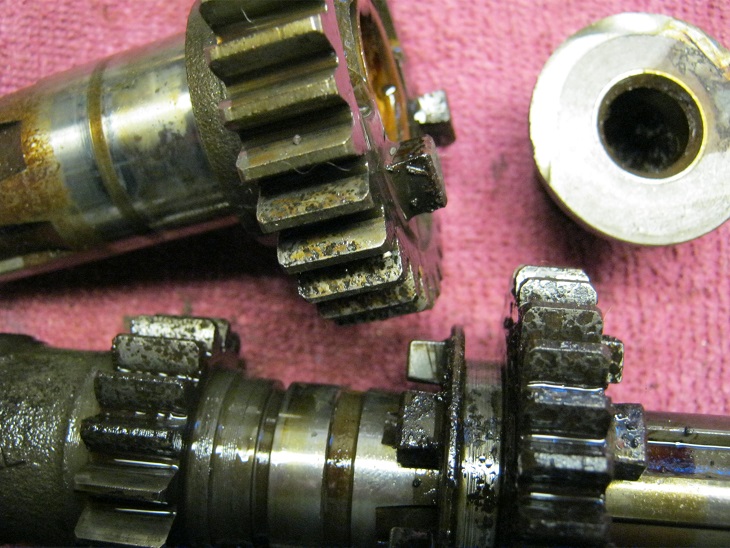

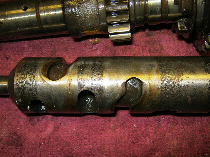

Cases split
My gut feeling told me to split the cases and I'm glad I did as the elements have taken their toll. Cases were full of sludge and the transmission has some deeply pitted gearing. The crankshaft seems okay but it's hard to tell so I'm going to replace with a known good one. I have a really nice transmission for a replacement. I was able to save a few of the existing transmission gears and while pulling it apart noticed it has offset cotters. I thought I had read somewhere that Bill Silver had mentioned none of the production bikes had these and were replaced after the bikes were sold. If so kind of blows my theory that the cases were never split on this one. It has also had a clutch replacement.

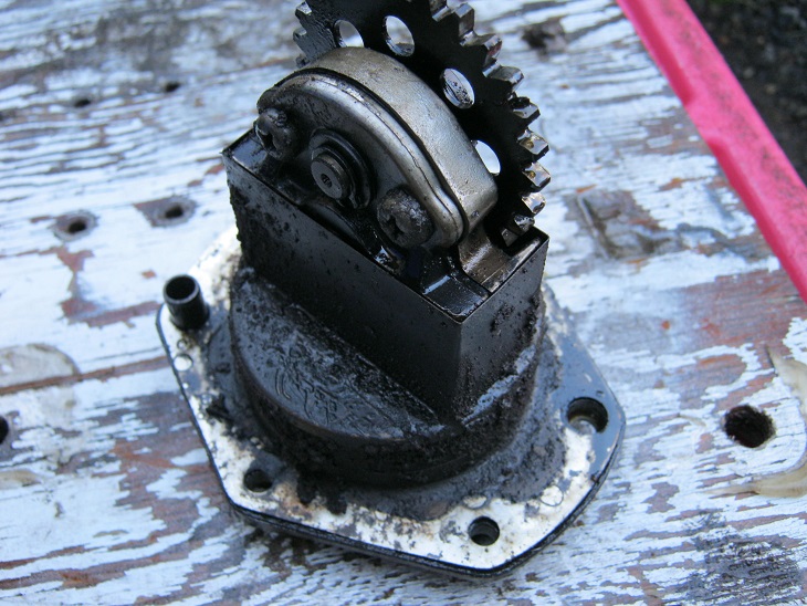

Checkout this picture of the oil pump, In 20 years I have not had one of these engines with as much sludge as this one. I'm amazed it actually pumped oil to the head! Everything in the case will be replaced. The only good part of this engine is the head after I replaced the bent exhaust valve. I'm having to scrape the crap off the inside of the case. Nothing seems to cut through it.

It certainly makes you wonder for sure! I would have bet when I bought it that it had never been apart as it showed no tell tale signs, however I would have lost that bet as it had the new pistons, offset cotters and an AM clutch installed. Somewhere in there had to be an oil change or two. : )sarals wrote:I have to wonder if the oil was EVER changed in that engine?
