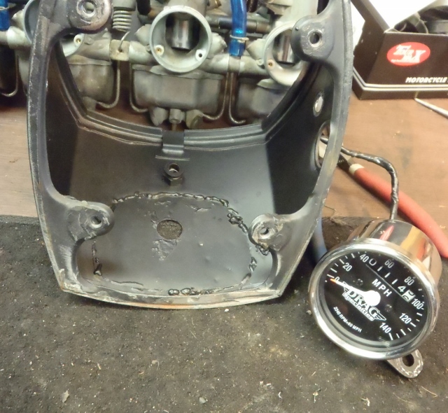

custom cables for speedometer
I received my cables back from Motion Pro. The custom speedometer cable cost $55 plus the cost of shipping the drive gear out to them to template and shipping my order back to me. The speedometer was around $50. Total build/work time was about 5-6 hours not including the wait time of drying filler and paint.
Motion Pro had no problem making the cables, they had the parts on hand.
I originally planned to mount the new speedometer in the same location of the old one, but as you can see I went in a different direction. It's easier to see/read and has a different look.
I ordered a cable sheath 34 inches, for the way I mounted the speedometer it should be an inch or two longer and maybe 1/2 to an inch shorter for mounting in the headlight bucket. Use this info only as a reference. If you order custom cables measure the lengths yourself.
Don't bother to ask me for a part or order number so you can order a similar cable. Motion Pro does not create a part or order number that is tied to the specification of a custom order, they do so many custom orders it would be too much for them to document each order. I know this because I ask. If anyone wants to do something similar start by visiting the Motion Pro or other cable shop web site and making a drawing of what you want.
To modify the headlight bucket I cut off the raised lip using a hand grinder and cutting wheel. I templated the hole to a piece of sheet metal which I MIG welded in place after ensuring a proper fit and drilling the hole for the cable to pass through. If I had mounted the speedometer in the bucket I would have cut that hole before welding also. I ground and sanded down the welds, added a little body filler, sanded the filler, and painted. I'm posting some full bike pictures in the project folder.

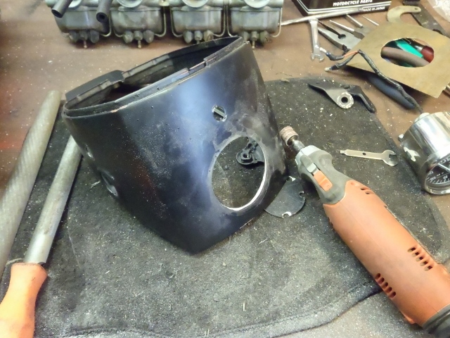

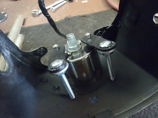

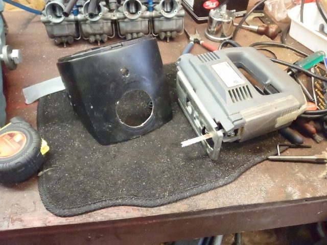

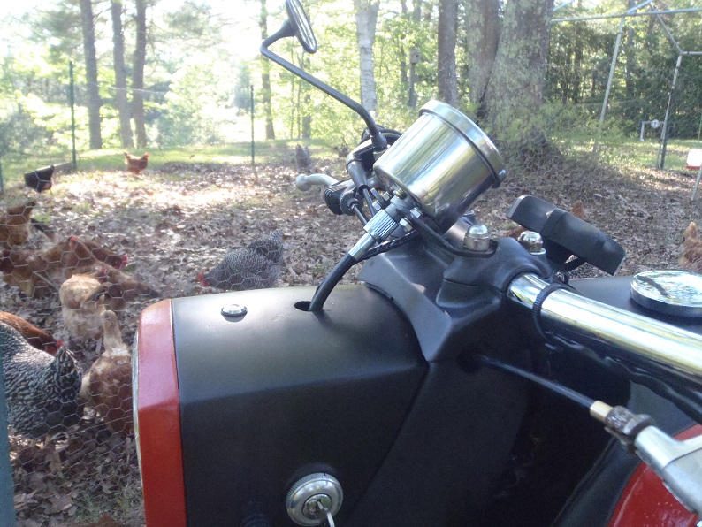

Generic Universal Speedometer Mouted in headlight Bucket
A couple of weekends ago it was raining, so I decided to try mounting the generic universal speedometer I mounted to the handlebars into the headlight bucket. It took about an 1 1/2 hours.
I cut a undersized hole in the blank that I welded to the bucket, then slowly filed it the the correct size. I achieved a nice snug fit. I straighten the brackets I made to hold the speedometer to the handlebars and installed bolts to hold the speedometer in in place.
- P5100021 (640x480).jpg (39.28 KiB) Viewed 6126 times
- P5100017 (640x480).jpg (65.8 KiB) Viewed 6126 times
- P5100015 (640x480).jpg (66.73 KiB) Viewed 6126 times
- P5100010 (640x590).jpg (70.94 KiB) Viewed 6126 times

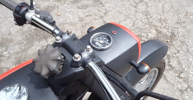

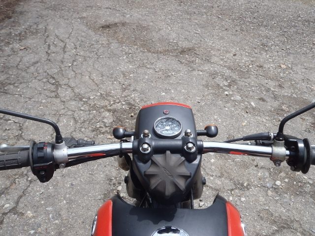

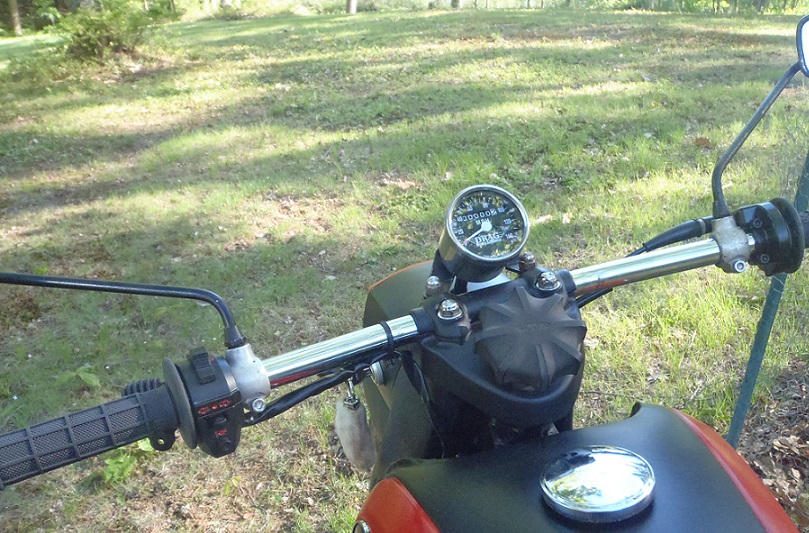

Generic Universal Speedometer Install
The Final Photos
- P5100025 (640x331).jpg (48.42 KiB) Viewed 6121 times
- P5100024 (640x480).jpg (80.2 KiB) Viewed 6122 times
