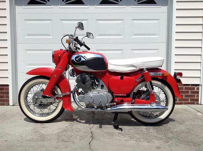

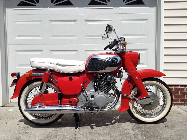

It's on the road and running like a Dream
I've only put about 175 miles on it so far. Still shaking things loose and retightening fasteners, chasing electrical gremlins and everything else that goes with starting a restored bike.

Nice job! What did you end up with for mufflers?

Looks great! Ya done good.
Regarding starting, since the Dream has only a choke but no enrichener circuit, I've found that kicking mine through a couple of times with the gas on and the ignition OFF primes the cylinders, making for easier starting.

you will note that Honda has provided a "priming" position on the ignition switch (dreams). the electric starter runs, but no ignition. this is the way I always cold start any vintage Honda. full choke, no ignition---- kick it over twice. then key on and kick. should rev with no choke after 1 min. (electric start is only for warm starts).
