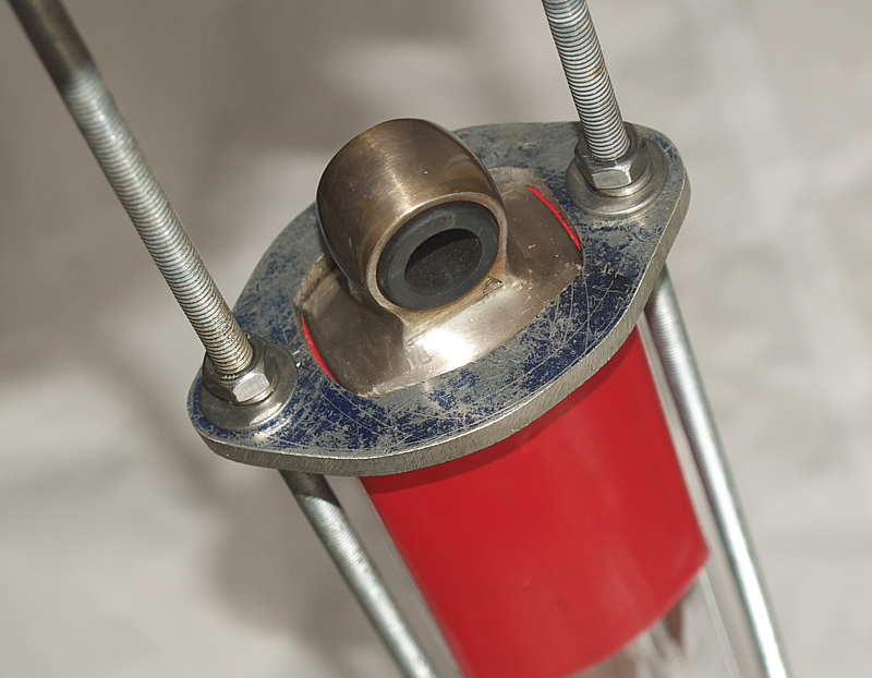

Post by G-Man » Tue Feb 22, 2011 1:12 pm
Pretty sure that those parts are rough polished then lacquered. Same finish as the rear shock tops.
The picture is a genuine NOS C71 part which shows the lacquer. It may have darkened a bit but it's definitely lacquered.
My C72 shock mounts show signs of lacquer but corrosion has taken hold pretty severely.

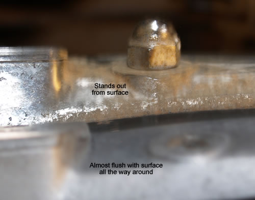

Post by nc_rider » Tue Feb 22, 2011 2:40 pm
I took a pic of a shock support plate from my '64. Notice how rough it is? It hasn't been polished. My guess is it was just painted silver.
Also check out the other image where I put it next to the one on my parts bike.. there are some slight differences in the shape of the pieces.

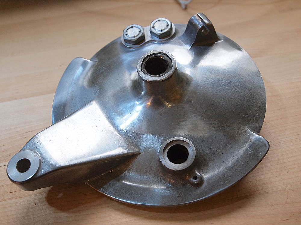

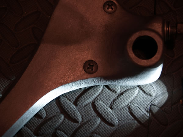

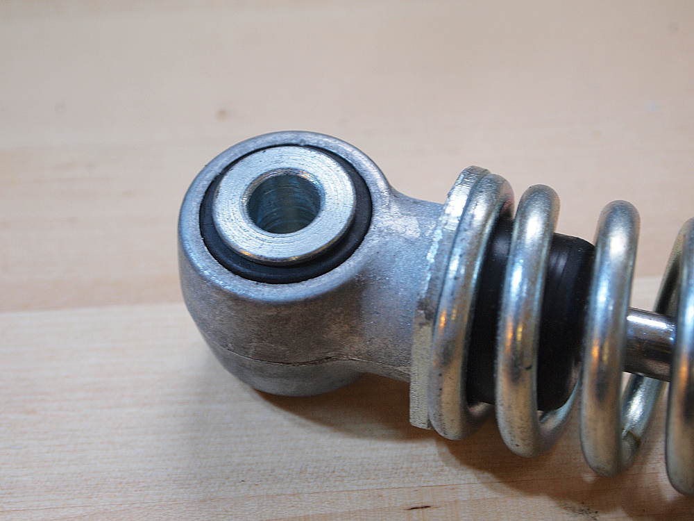

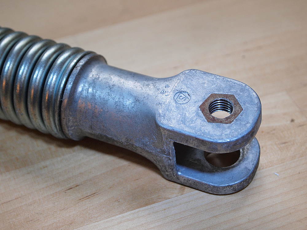

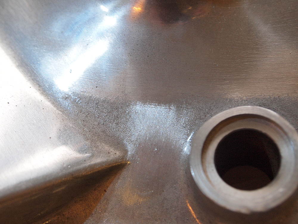

Post by G-Man » Wed Feb 23, 2011 10:29 am
Some pics from my shelves...
Just looked through 10 sets of rear dampers I dismantled. All show signs of lacquer.
NOS CL72 brake plate. Lacquered over linishing. left unpolished where they couldn't reach. Time is money chaps....
NOS Dream front shocks - no lacquer on top or bottom alloy. Time is money - especially when you cannot see the result.......
My C72 will have lacquered shock fittings, shock mounts and wheel hubs.
Happy fettling......
