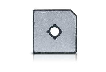

I've had the harness unwraped compleetly and determined that I'll have to tap into the black neer the ignition switch. Black seems to feed every light on the bike as well as the horn and solonoid. Looking forward I'll need a rectifier. Is thier a brand or type that would work best? I see no regulator at all in this system so I don't want to get the wrong type. I suppose it would be better to ride with the lights off rather than try to cook up some way to wire in a regulator.

Most (US-based) modifiers here seem to favour the 25-Amp bridge rectifier from radio Shack; the 25-Amp will run less hot than a 15-Amp, but you'll still need to bolt it to a heat sink.
A healthy charging system, with a modern solid-state rectifier, is perfectly adequate and needs no regulator. I ride with my lights on, constantly; I have winkers (2 x 23W) and a compact air-horn. I always use the electric starter -- my k/s pawl is screwed -- and most of my rides are short (<15 miles). I'm using a Motobatteries' MB9U AGM 11Ah battery. Look back through some of my posts and others' responses regarding the topic of 'charging improvements'; this topic also has some interesting contributions.

Might need a part # to get a rectifier or heat sink from radio shack. The clerks always scratch thier heads and try to sell me a tv antena when I ask for anything technical. I did find a 25Amp rectifier 50V that I'll try to see if they have at the store.
