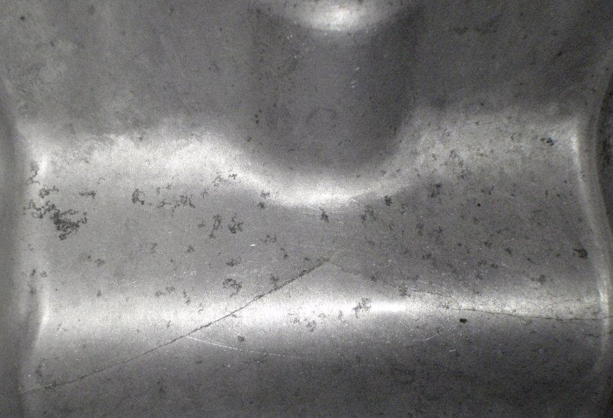

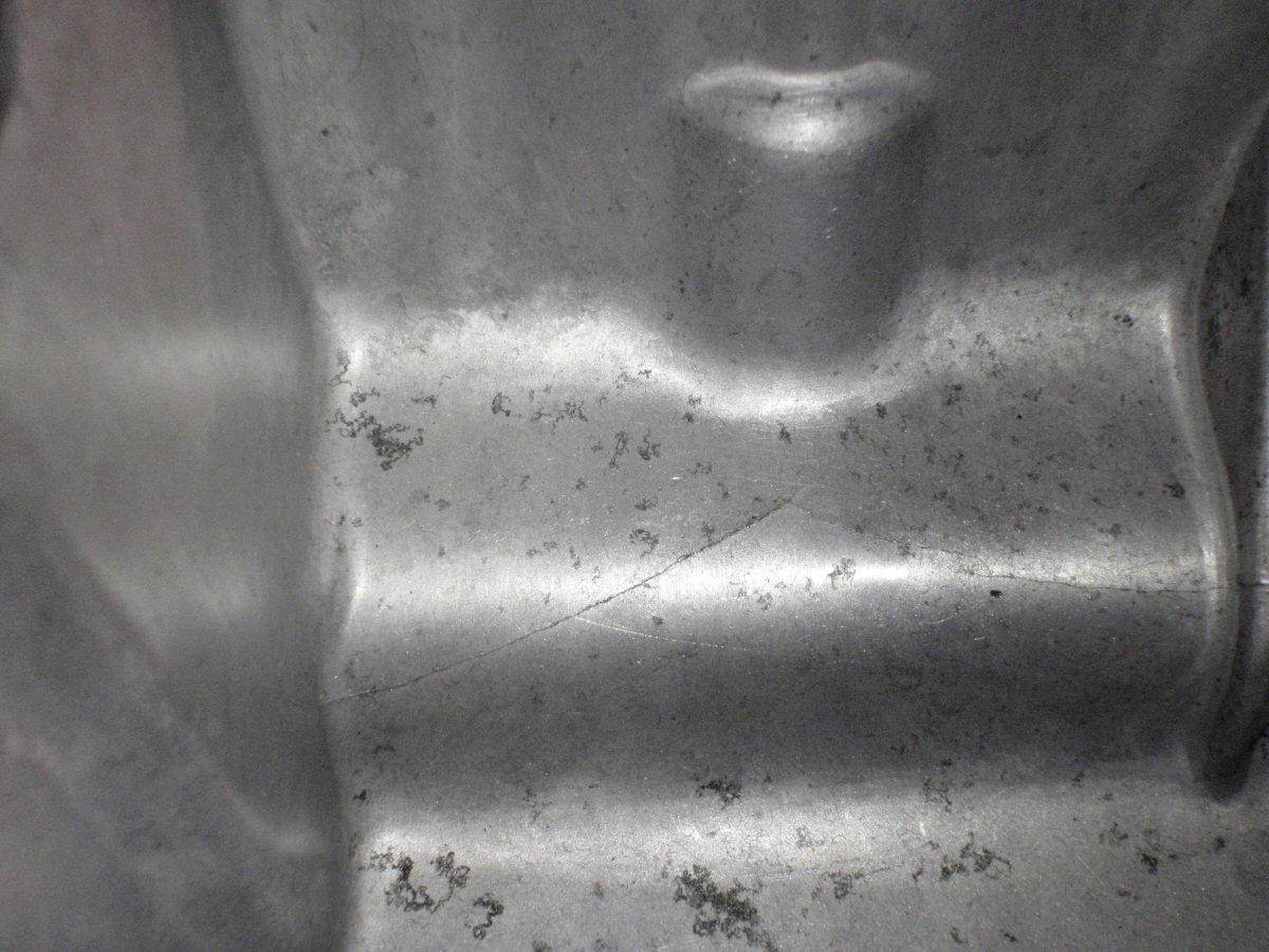

Hi,
I was intrigued by this crack, so I looked in my garage to see if this crack appeared in other crankcases because I was sure that I saw this before.
Well, I found another case, just like yours, with the same crack in it. I'll take it to the metallurgist and see why it's there.
Jensen

Post by jensen » Sun Jan 24, 2010 10:10 am
Hi,
To compare even better, I put both cracks in the same size photo's.
It seems that both "cracks" are almost identical, some sort of footprint from the mould.
I tested this crack in the morning, and it's not really a crack, more a open surface, well, as I'm not a specialist on old aluminum -zinc alloy castings, I will see what the metallurgist says about it, I'll speak him this week.
in the mean time I'll check my other crankcases, from both CB72's and C's to see weather these casings have the same "crack".
Jensen
Post by LOUD MOUSE » Sun Jan 24, 2010 10:36 am
Check the inside of the clutch cover and ya will have your (visual) answer. ..........lm
jensen wrote:Hi,
Jensen

jensen
Posts: 1143
Location: netherlands, huizen
Post by jensen » Sun Jan 24, 2010 12:18 pm
Loud Mouse,
You talk in riddles, I checked my clutch cover, what am I supposed to see ?
I see nothing in particular, except that the "crack " runs to the clutch center bearing.
I do not have the clutch cover with this crankcase, but picked just one.
LM, help me out here with conclusions.
Jensen
