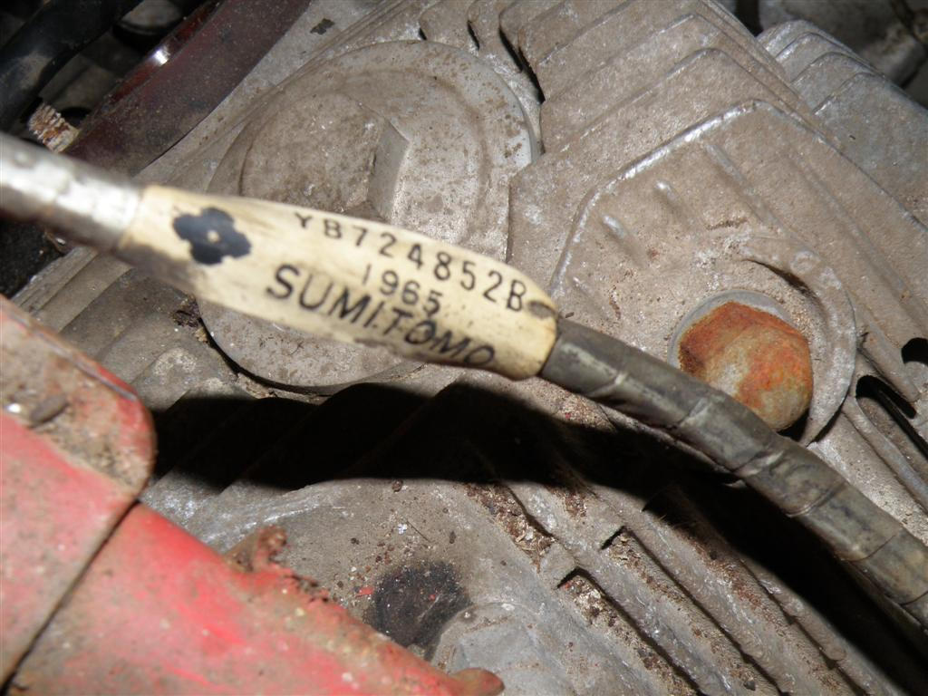

Whip off the tank and look for the wiring harness year tag.

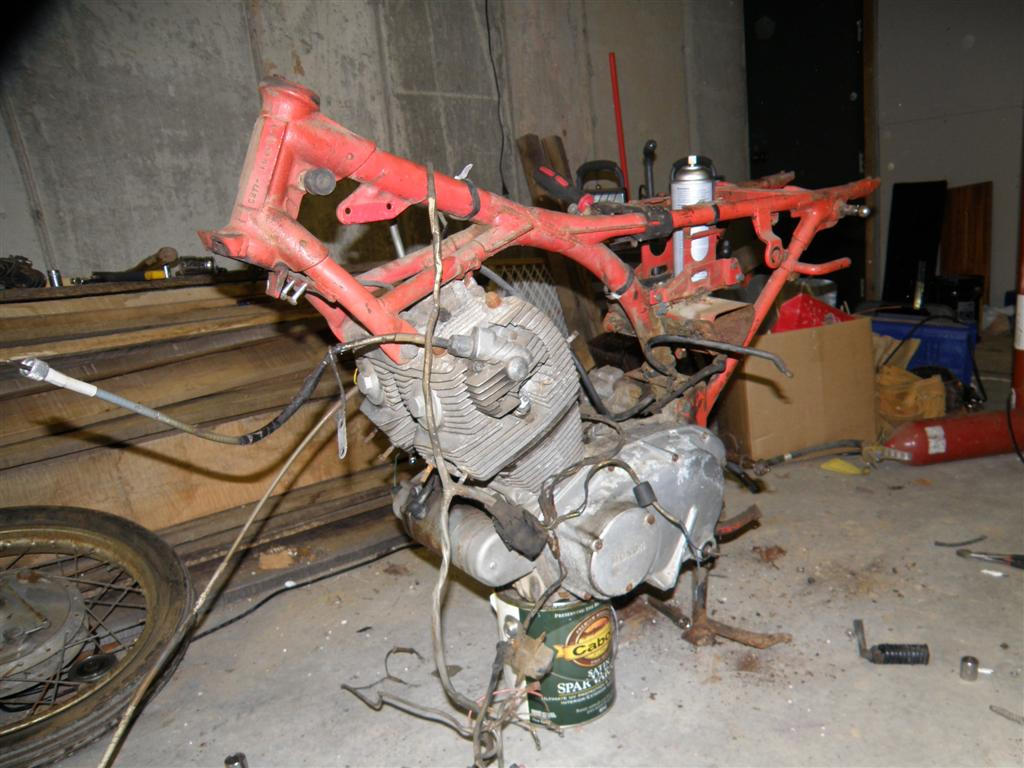

Thanks e3steve! I already have the tank off and alas the year tag on the harness is long gone. I have the bike down to the bare bones now and am removing the forks. It looks like someone had removed the front wheel in the past and put it back on backwards! Didn't even have the brakes hooked up or anything. I took pictures of all the wiring in the headlight before I cut it for removal so I have a record of what went where. The speedo cable wasn't attached nor were the light bulbs installed in the speedo so I am guessing that the speedo didn't work.

Post by banksc1970 » Sat Sep 19, 2009 1:47 pm
Everyone was correct! I found the year tag (taped over). It states "1965"! Here are some updated photos of the tear down and the year tag.
year tag "1965"
year tag "1965"
Sans front end
Sans front end
Sans tree and forks
Sans tree and forks
