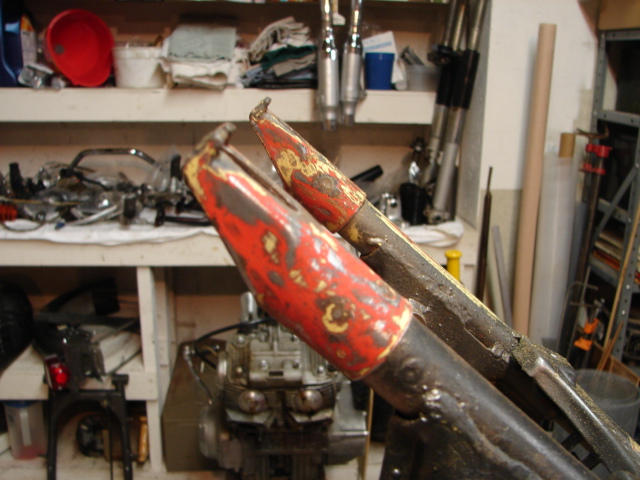

today marks the official start of Bob's reincarnation. I finished wiring in my heated grips and fuseblock on the GL 1500, and got the '67 CB 77 starting first kick again after cleaning the points and giving the sparkplugs the toothpaste treatment. I will attemp to attach a couple pics or links. I dont think I got all of them on photobucket. If they come through, you can see that Bob was originally red. Food for thought

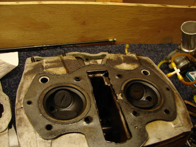

I have my Goldwing running and out of the basement. Serious work now commences. I pulled the head and cylinders tonight. I see that the head gasket is blown. Now I know why the po sold it to me ( aside from running into something fast enough to bend the forks.) I also have good bores and pistons and rings. Pistons are marked 0.75, so I can assume I'm on the last rebore. Glad to see they look pretty nice. Lots of odd nuts and hardware. Lower back corner of right side cover broken off ( not fatal). Did lose the sideplate from the master link in the engine even though I had the opening packed with paper towel. I was going to check everything inside anyway, right ? Everything that I can see inside looks good. Will try the grinding deal on the cam chain tensioner-its pretty hard. Will glass bead everything after its stripped and inspected.

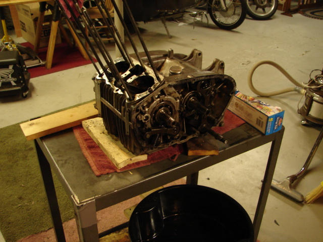

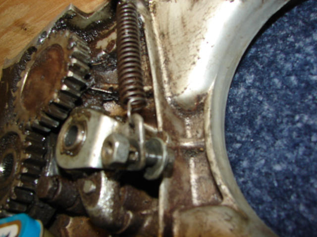

Started tearing down the engine today. Found some surprises. P.O. had used a mixture of odd nuts in the quest to kee ol' Bob operating in the past. Note the pic below of the clutch release mechanism. Cable end receptacle long gone, so a cap head bolt was drilled, the cable wire inserted, and a nut on each side was tightened to hold the cable end in place ( rather original I thought.) I can see I will be sourcing some parts. From what I can see, the right side cover and attendant items are the only real problems with the engine. Note also the blown head gasket. Inside of engine is a bit dark like cooked oil. Wonder why.
