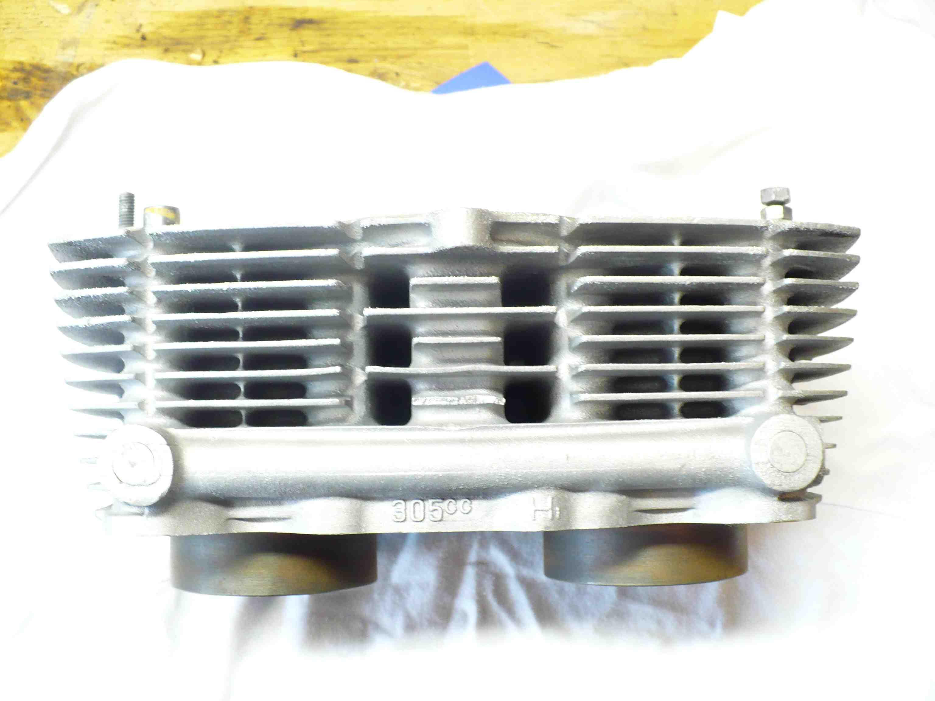

Well I finally feel like I've accomplished something. I finally got my free sandblast cabinet. It wasn't big enough and didn't work. So I had to go out and purchase a new cabinet. It was $150 I could have spent on parts, but I guess my piston order will have to wait until next payday.
After a few small test pieces I masked off the cylinder and blasted it. I soon realized the extra cash I forked out for the blast cabinet was well worth it. The results were great and bitter sweet when I think about the hours I had spent scrubbing the block with brushes and solvents.
I have some questions I'm hoping someone can answer.
1. I have been masking off the gasket surfaces on the pieces I am blasting. I'm assuming it is not safe to blast these surfaces. Am I correct. I'm using glass beads as my medium.

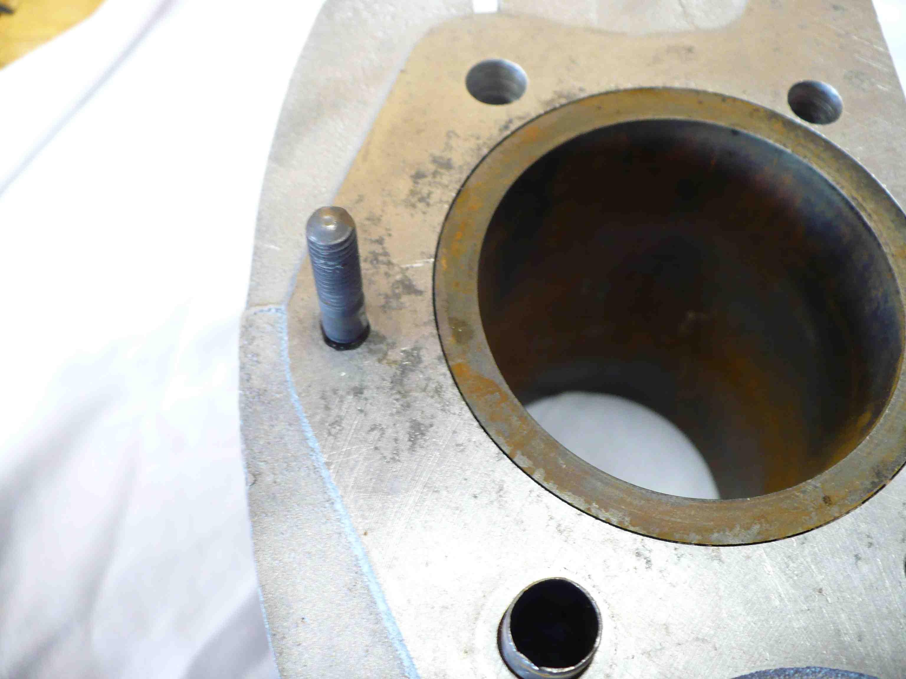

2. How clean do the gasket surfaces have to be. I am having trouble getting them as clean as I would like. I've included a picture. There is still some "clouding" on some of the surface areas but I can't feel anything when I run my hand over the area. I've been using gasket remover and a brush to remove the gasket. I'm guessing you're all going to tell me to put some more elbow grease into it:)
3. I've been finding some "surprises" that previous service men have left me. The oil drain plug is perfectly round. One thing that concerns me is the head gasket. The surface looks a little ruff and is obvious someone scrapped a gasket off with little care for the surface. I am wondering if it is recommended to resurface this area. There didn't seem to be much of a leak at this site before I disassembled the motor.

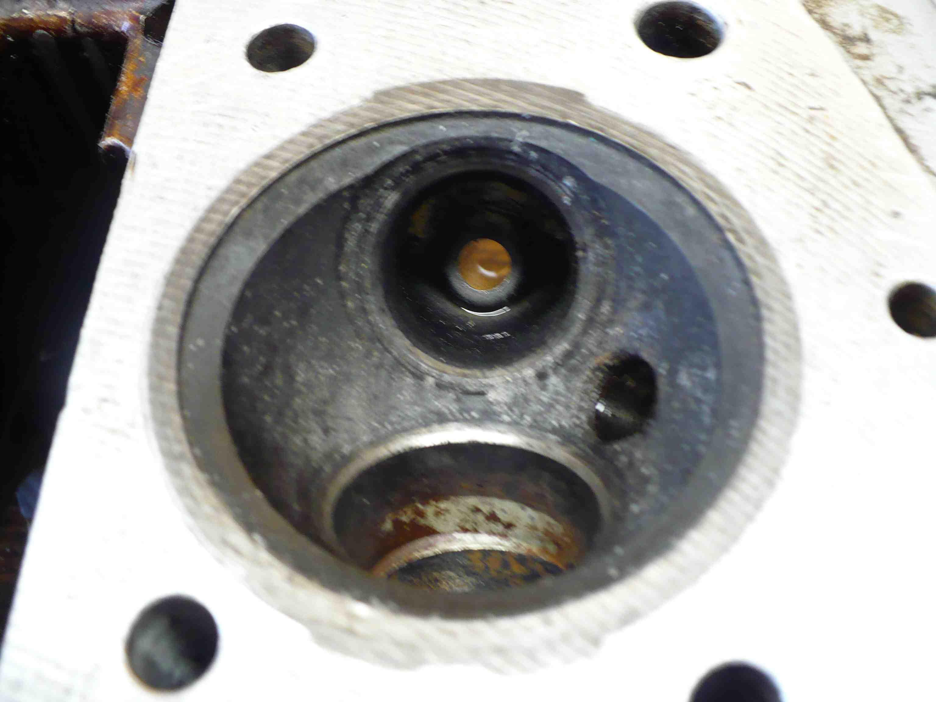

4. How do you clean the valve seat area/dome on the bottom of head. (Sorry don't know the tech term:). Is it even necassary to clean this area?

The top of the cylinder assy looks good to me. Looks as though you may be using SHARP MEDIA. Put a spot of oil on a Blasted area and observe if the oil penetrates the aluminum. If it does ya better change to ROUND MEDIA. I have extra exhaust valves (smaller head than intake) and I put them in with the head at the spring end of the guide. This way I can ROUND MEDIA blast the ports. I also put screws/bolts in any threaded hole. ...............lm
