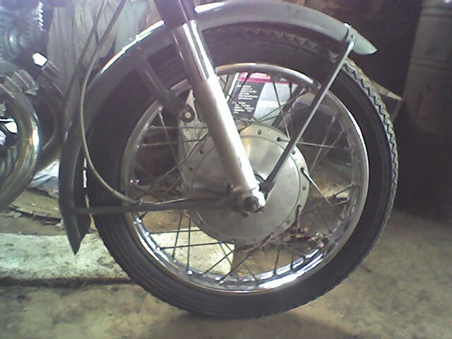

I've been moving my bikes around, so it took me a couple of days to get this pic taken. I'll take better pics soon if this does not suffice. This one was taken with my phone.
This picture shows the fender attached only by the front and rear stabilizer arms. You can see how far off the tire the front and rear edges of the fender are. You may also be able to tell that the center mount is not correctly lined up with the locating tabs or bolt holes.
I don't think I'm putting it on backwards, because the loops for the cables are correctly located on the rear stabilizer arms.
thanks for looking,
burvis[/img]

Post by LOUD MOUSE » Tue Mar 31, 2009 10:45 am
From what I see the middle attachment has been moved from it's original location for some reason. Ya may want to look apx. 2 inches to the front for obvious holes. If not visible from the top look underneath. I doubt this was ever installed on your bike as it is. ......................lm

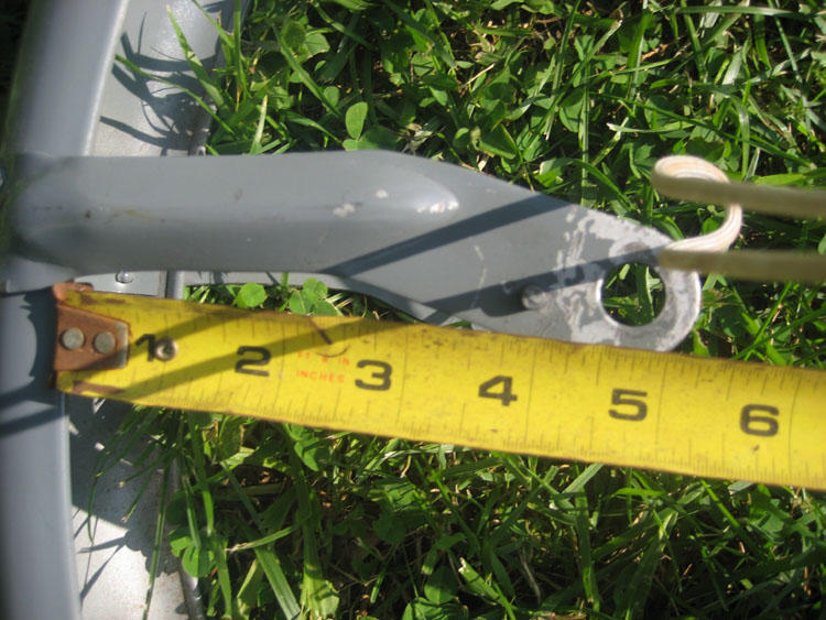

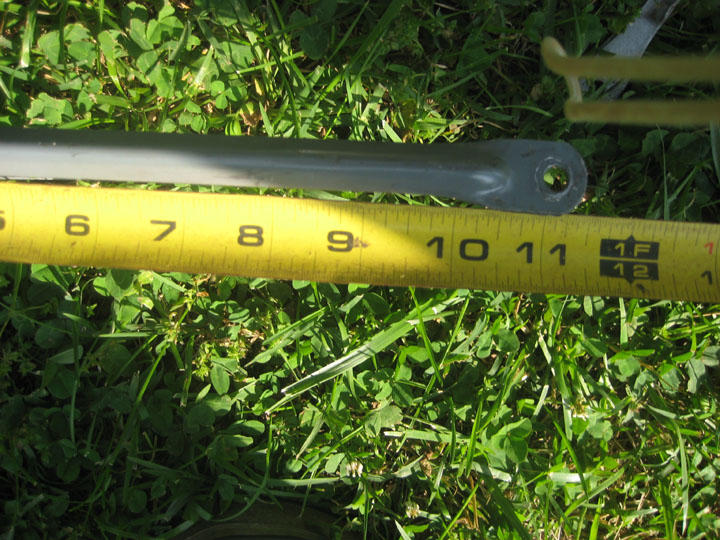

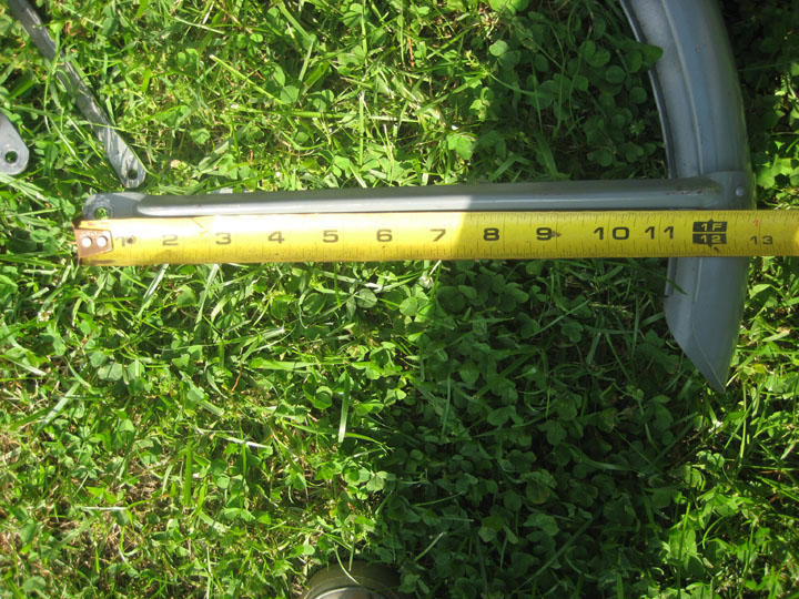

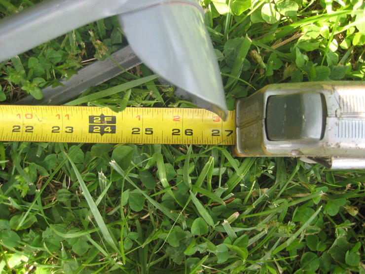

good pics at last- help id'ing this fender?
Post by burvis » Thu May 14, 2009 8:57 am
So I must have been mistaken about the fender fitting in the first place, and it seems I may have a fender for steel sliders (mine are alloy). If anyone can tell by these pictures, and if anyone wants to swap fenders, this one is in pretty decent shape. It just doesn't fit my bike properly.
I gently hammered out dents in the leading and trailing edges, sanded off some surface rust and primed the fender. Any scuffing in the primer is from me trying to wrestle this fender onto the bike.
[/img]
length of the rear stabilizer, the ones wth the loops for the speedo and brake cables
length of the front stabilizer arms
length of the center mount
this is a picture with a tape drawn across the fender opening, from the leading edge to the trailing edge, 27"
Re: good pics at last- help id'ing this fender?
Post by LOUD MOUSE » Thu May 14, 2009 11:07 am
Pic #2 tells me ya have the Steel Slider issue. .......lm
