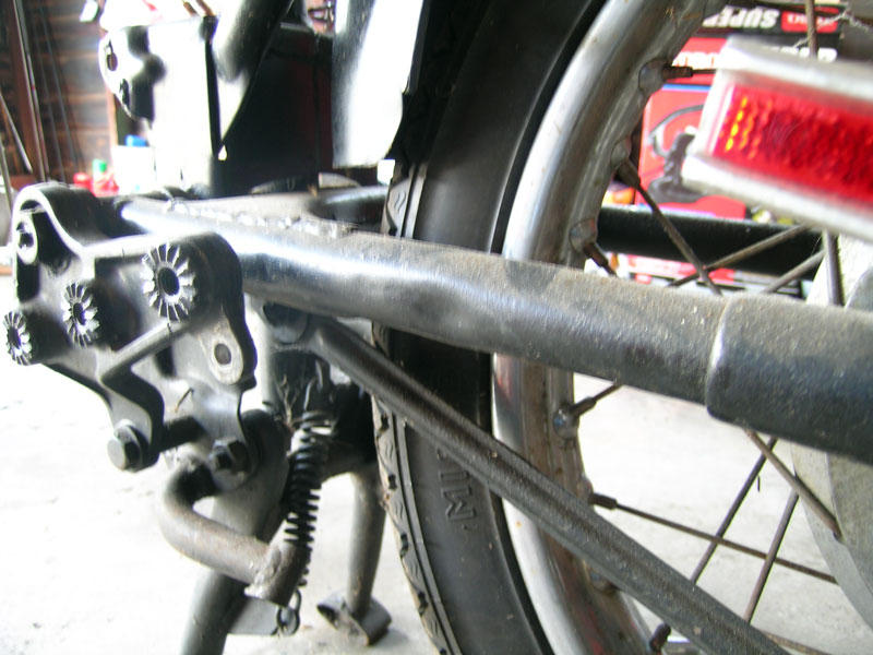

One last question thing: the left side of the swing arm has a dimple or dent about 2/3 of the way to the rear between the pivot and the rear axle. Are these swing arms supposed to be completely round or is the dimple part of the design? I don't see the dimple on the right side of the swing arm, so I am thinking the former is true and this may be a result of the bike being dropped. This may also explain why I wasn't able to adequately adjust the rear axle to be square. I'll snap a photo next time I'm working on the bike.

The sping arm is round all the way. ...................lm

Looks like I'll be looking for a donor bike with a good swing arm also.

I removed the rear wheel and remembered that I wanted to take a picture of the dent in the swing arm. See attached picture. I've seen a couple of swing arms on ebay recently, but I'll keep on the lookout and perhaps a more complete parts bike or basket case.

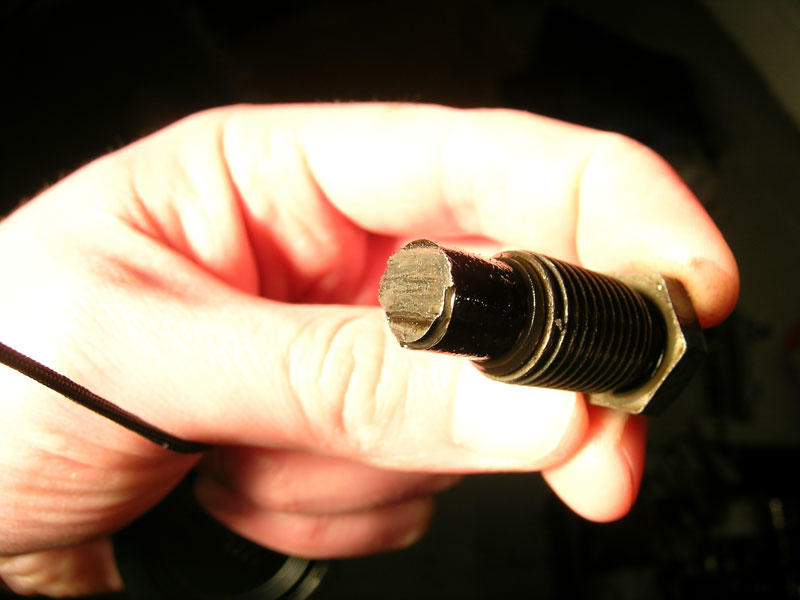

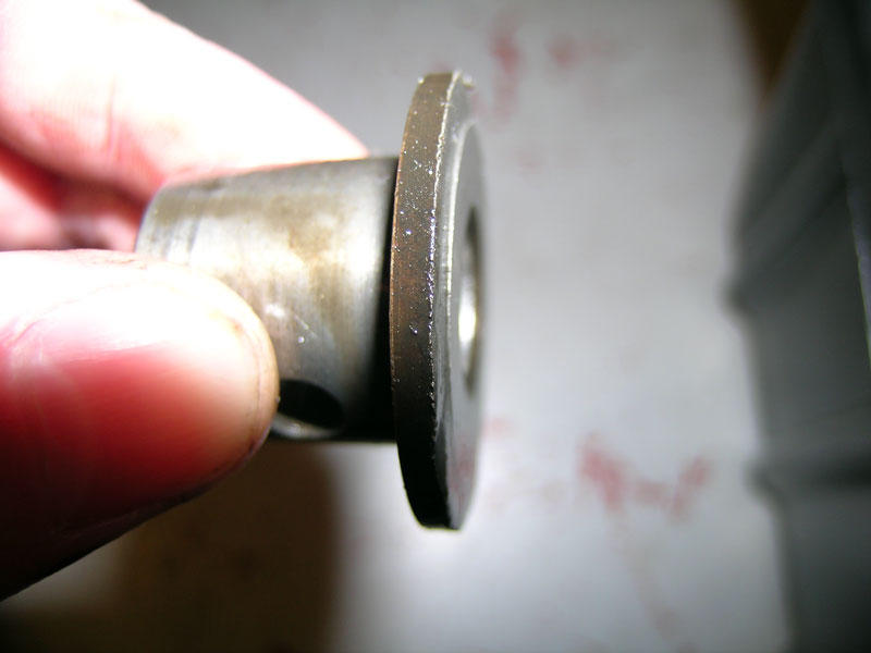

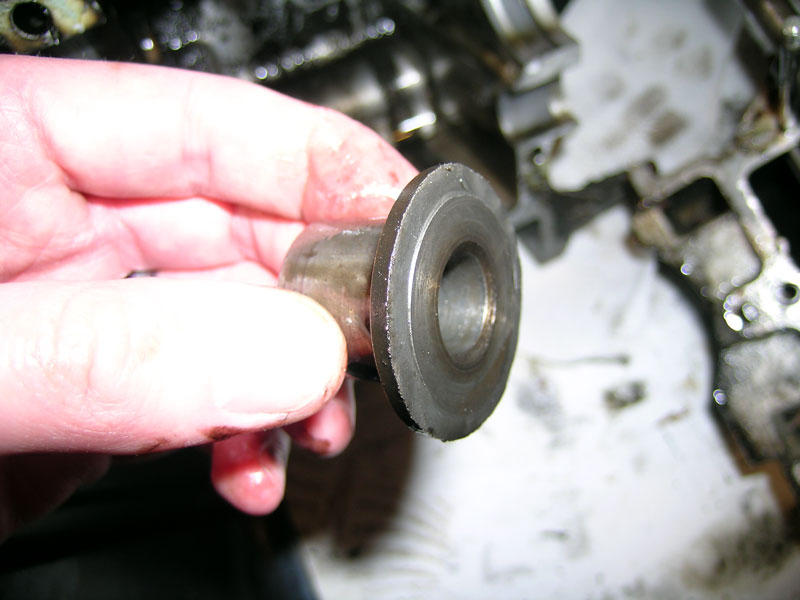

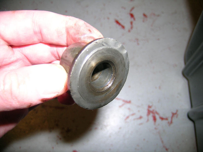

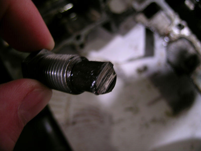

The end of the kickstarter stopper bolt shows obvious wear where the edge of the low gear was rubbing due to the apparent wearing of the kickstarter spindle end bushing.
OK, here we go with some pictures.
Kickstarter spindle end bushing.
Kickstarter stopper bolt.
